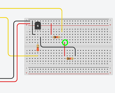

What am I doing wrong if current flows through the PN2222A transistor even when digitalWrite is set to LOW? There is a 1000 Ohm resistor connected before the Base. There is no external power source, only the Arduino 5V.
In the picture, the bottom resistor would be the unknown one that I will measure. The right side is the known 2000 Ohm resistor.

According to the simulation in Tinkercad, it should work. When current = 1, digitalWrite is HIGH; when current = 0, digitalWrite is LOW. However, when assembled, the serial monitor shows 5V and 2046000 Ohms when LOW.
Install same 1000 ohm resistor PN2222 base to GND. That should shut it off.
LOW is not zero volts.
The collector is not connected to anything.
A0 is connected to 5V.
What were you expecting to see?
