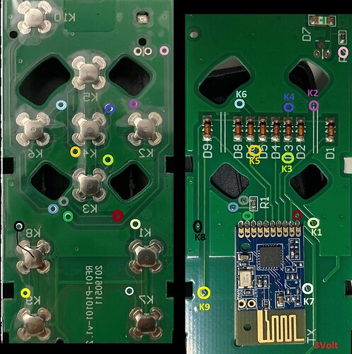

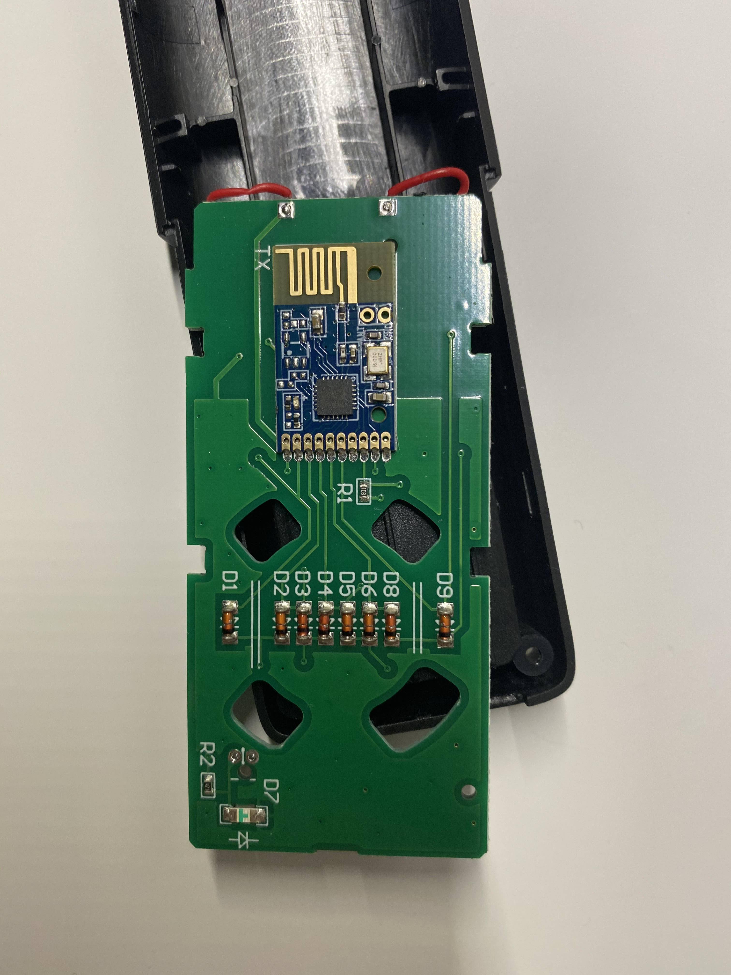

I have a RF Remote control (RMT-02-PJ) with several buttons that controls the TV Lift (HP 33-1L). After initial setup of the TV lift, I now only need two buttons that do the following:
  • Button1 ("K1") - if pressed once, duration does not matter- lifts the TV in the viewing position.

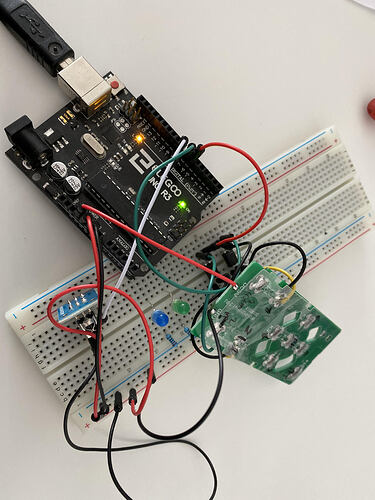

I started building a program and wired a circuit on a breadboard that lets me control 2 LEDs with my IR remote - upon pressing a button on the IR remote, the LED goes on, upon pressing it again it goes off. Two different buttons, two different LEDs. IR receiver is connected to Pin8, LED1 to Pin7, LED2 to Pin8. The idea is now to replace the LEDs with the buttons K1 and K8 on the RF control.

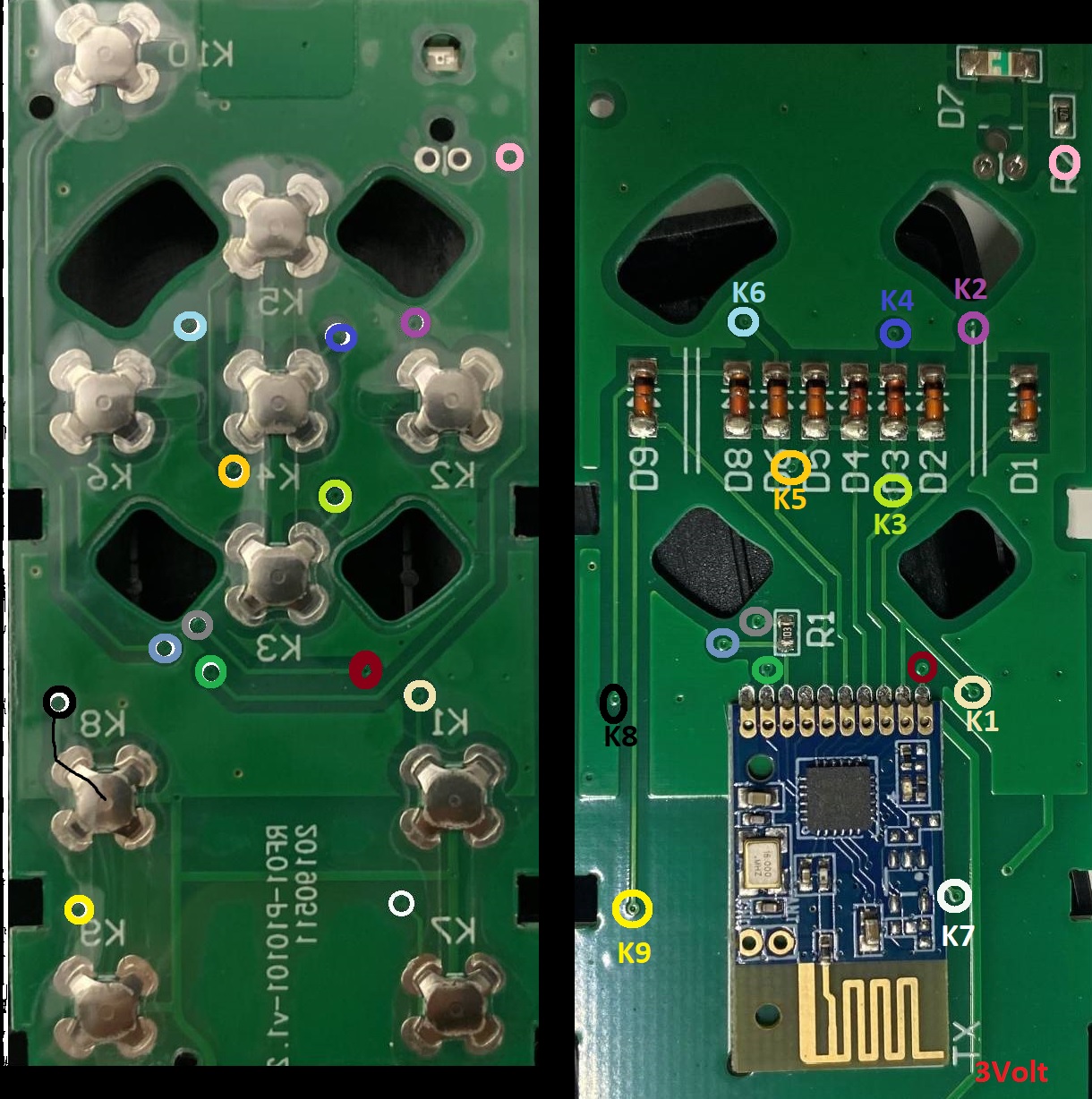

  • How to now connect the Arduino to the RF Remote buttons of the TV lift (where to solder, how to do the wiring, any resistors needed)? The two buttons that need to be controlled are K1 and K8 on the picture below.

Edit: I tried to match where all the wiring of the circuit goes - have a look here: https://i.imgur.com/5amccRL.jpg
Replace or add opto couplers to the current LED outputs, the o.c. outputs to the remote buttons. Check the polarity of the button pins, connect emitter to the negative and collector to the positive pin.

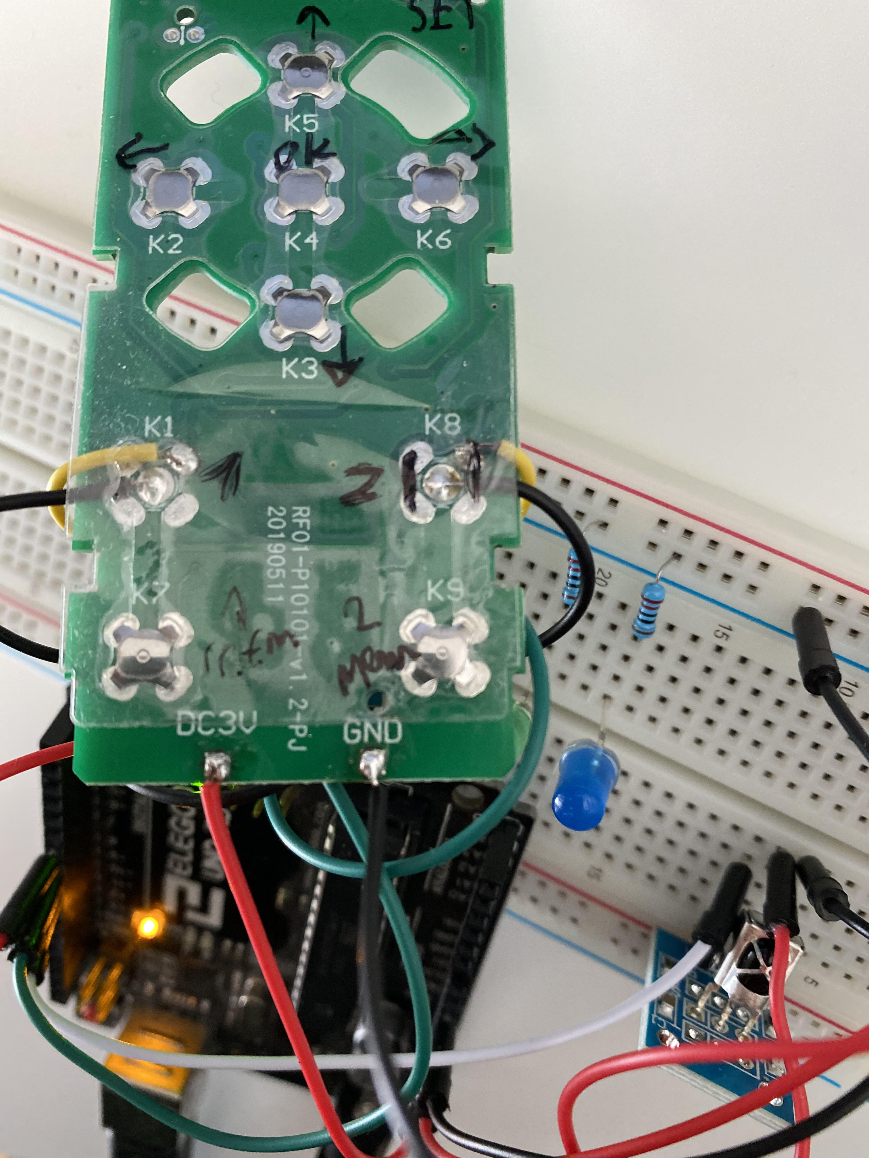

My naiive idea was just to solder a cable that connects the pin of the arduino that was intended to send a signal to the LED to the RF remote instead.
So I thought I would connect the cable that feeds the Anode of my first LED with the Diode on the RF:
  • Arduino Pin 7 to RF circuit D9, getting signal from K8 (black)
  • Arduino Pin 8 to RF circuit D1, getting signal from K1 (sand)

  • The RF circuit is powered by two AA batteries, but the input reads 3V. Can I also just add a 3V pin from my arduino to power the RF circuit? Or do I have to stay with the AA batteries?

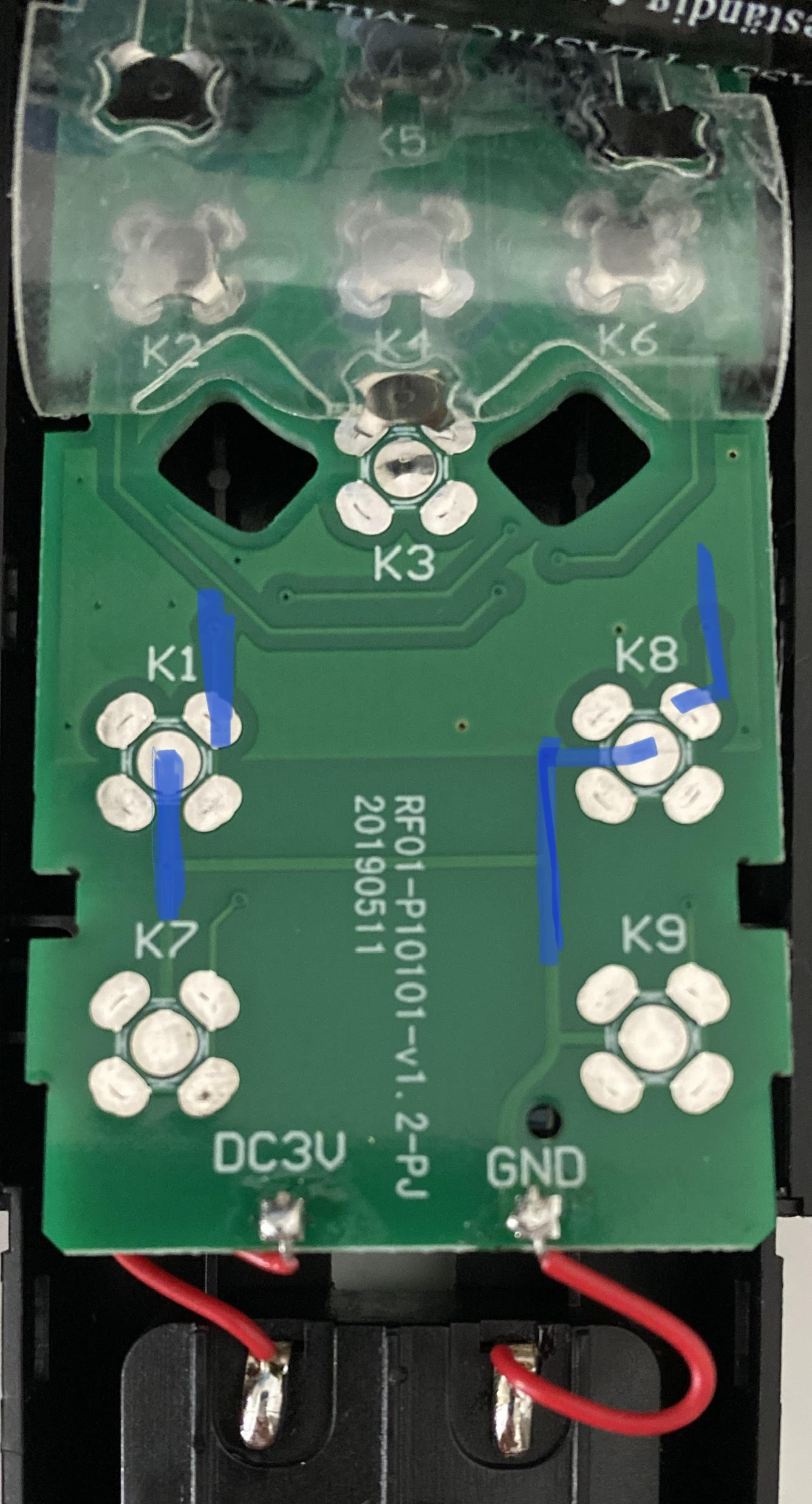

Hello together, whilst waiting for the opto-couplers to arrive, I started trying to learn more on the wiring of the buttons. They are glued to the circuit using some transparent film, i thus lifted that film that keeps the buttons in place and saw the pattern shown in the picture below.
I took a multimeter, set it to Ohm (200) and touched the black and red tip - it displays values between 1.6 and 2.0.
I then touched each combination of the metal dots at the outer part of the button, and each time the value displayed is between 1.6 and 2.0. It seems like all the four are connected.
If I touch the centerpiece of the button and any of the surrounding nodes, the system displays "1 ." indicating that there is no current flowing.
Is it right that I thus have to solder a wire to the center of the button and to any of the nodes surrounding it to connect my circuit (see blue sketches on the picture)? (I assume the top right node is fine for the buttons as from there the connection leaves on the circuit, and the center piece is the GND part - can be seen on the photo below). if I connect both ends of the soldered wires it should do the same as pushing the button, right?
Looks correct so far.

This is everything in action:
Animated GIF (cannot be linked): Imgur: The magic of the Internet
This is the circuit:
This is the RF remote:
