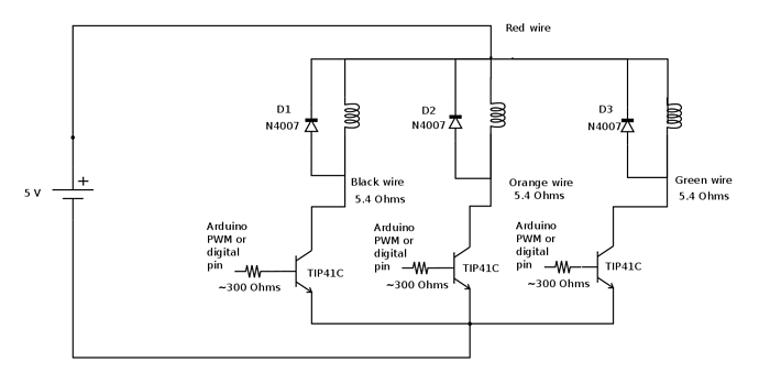

Hi All,
I am planning to mount a controller according to the diagram:
I would like to know the opinion of the experts about the viability of this project.
What would be the most appropriate capacitor (parallel to the source) to control the BEMF?
I intend to use the PWM pins of Arduino to control the speed of the motor.
This motor has 4 wires (Black, Red, Orange and Green).
I measured the resistance and got the results:
Black - Red: 5.4 Ohms
Black - Green: 10.2 Ohms
Black - Orange: 10.2 Ohms
Red-Green: 5.4 Ohms
Red - Orange: 5.4 Ohms
Orange - Green: 10.2 Ohms
Is this circuit is feasible?
Thanks for your attention.
Markos
Not seen that circuit config before, but one thing is certain, the transistors
should be at the bottom and the diodes at the top.
You cannot turn on an NPN as a high-side switch without providing a drive circuit
at higher voltage than the supply.
Use the NPN's as low-side switches and you will be able to turn them on
However since the Arduino cannot give more than about 30mA without
hitting the abs max limits, and the TIP41 has a usable gain of 10 as a switch,
you won't be able to switch more than 300mA with this circuit. Logic-level
MOSFETs would be better.
The purpose of the resistors eludes me - is it waste power? :slight_smile:

Dear,
I am using a motor from HD but a don't have any information about it:
I tried to open the top of the motor but could not.
I'm using the motor connector to measure the continuity:
And with the measurements I'm considering the following configuration (star with common wire):
You are right, I corrected the diagram of the circuit and replaced the resistors by the coils :
What to you think about?
I intend to use a power supply with a maximum output of 1.5 A, so I think I'll have to add a resistor in series with the output of power to control the maximum output current. Am considering using something around 5 Oms.
What do you think?
Markos

Dear Mark,
I corrected the diagram according to your suggestion:
Your suggestion called my attention to a feature of the transistors that I didn't know.
For me, a transistor would act as a switch, regardless of whether the load device is connected to the collector or the emitter.
You could indicate a tutorial about this topic?
At the moment I'm using the transistor TIP because it is the component that I have available on my desk.
I'll try to know more about the MOSFET.
Thanks for the tips.
Markos
Akvo:
http://www.c2o.pro.br/en/automation/download/BLDC_controller_4_wires.png
Yes, that makes a lot more sense. You won't be able to switch 2.5A with a TIP41C
unless you provide 200mA or so to the base though. You could change to using
NPN Darlingtons like TIP120/1/2 - then only a few mA of base current is needed.
No, you have to saturate a transistor to act as a switch and that can only be done
if the base is at a higher voltage than the collector (for NPN) or at a lower
voltage (if PNP).
A transistor in saturation has minimal voltage difference between collector and emitter,
perhaps 0.05 to 0.2V, whereas the base-emitter voltage is always going to be ~0.8V or more
(for a power transistor).
Failure to saturate means a lot of power is dissipated in the device and it could overheat
or need a fan to cool it!
Alas darlingtons like the TIP120 have high power dissipation too...
logic level MOSFETs are much better for this application I reckon.

Forget darlingtons, MOSFET is always the way to go.
