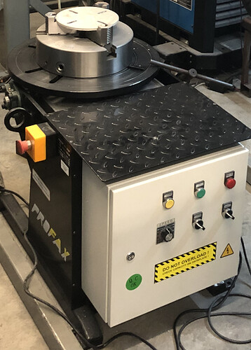

I am working on a project where I need to be able to control two different motors via a PC. I have a welding positioner that rotates as well as tilts (one motor powers the rotation while the other powers the tilt). The welding positioner is capable of rotating at speeds from 0.4-4RPM and I would like to be able to control the speed at which the positioner rotates. As for the tilt, the tilt of the positioner only moves at one speed so I only need to be capable of controlling the power supplied to that motor so that I can tilt to a desired position.
The motor specs are:
Rotation motor: 90VDC, 1800RPM, 100W, 1.85A
Tilt motor: 90VDC, 1800RPM, 300W, 4.9A
I understand that these are powerful motors and may be complex in controlling. I have a relatively large budget to utilize in order to complete this project so I am capable of utilizing a range of Arduino/circuit boards as well as instrumentation.
I am very new to this so I do not really know where to begin. I have tried searching methods for controlling a 90VDC motor via computer but I get relatively nowhere. I have read through other posts posing similar problems but I am hoping someone can help with my unique problem.
Thanks in advance
PS I have attached a photo and video of the positioner discussed. Just imagine the silver part in the photo spinning in a circle and that the rotation I talk about controlling in the post
Exercise treadmills often use 90VDC motors, and there are drivers for them. Here is one place to start.
There are many available that allow direct interfacing with electronic controls. You might look up under "Robot welding positioners". There are a lot that allow you to interface on the logic level rather then the power level. Some companies custom make them. Without schematics etc I cannot answer your question completely.
One thing I will comment on - there are quite a few cheap motor drivers out there rated upto 90V.
But its usually bad news to run any electronic device at its maximum rating, I'd advise finding
a motor driver capable of 120V or more to drive a 90V motor, or an industrial unit specifically
designed for 90V motors (rather than a unit whose maximum rating happens to be 90V).
