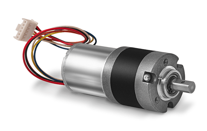

Thank you all for your replies and time. In the attachment, you can find the model of the 3-pole DC motor. The idea is to develop a head for a Camera Crane that can control pan and tilt. I've been thinking about how using a 3-pole motor would work for this project.
I have never seen a Crane jib with a 3-pole DC motor before.
Voltage: 24V
Type: 3 phases 12 poles brushless motor with 3 hall sensor
Current at nominal Torque: 1100mA
Power: ~27W
Thanks again.
E.
Probably with good reason !!
Servos are the usual solution , as you will need to have position feedback

I expect to achieve a maximum speed of approximately 50 degrees per second and will use a reduction ratio of approximately 1:8. It's worth noting that the motor's RPM at the shaft is 68 when operating at nominal torque.
I believe that in this condition, I will achieve smooth movements after the reduction.
the best that This 3-phase DC motor has the driver integrated inside.
how do you think it can work?
