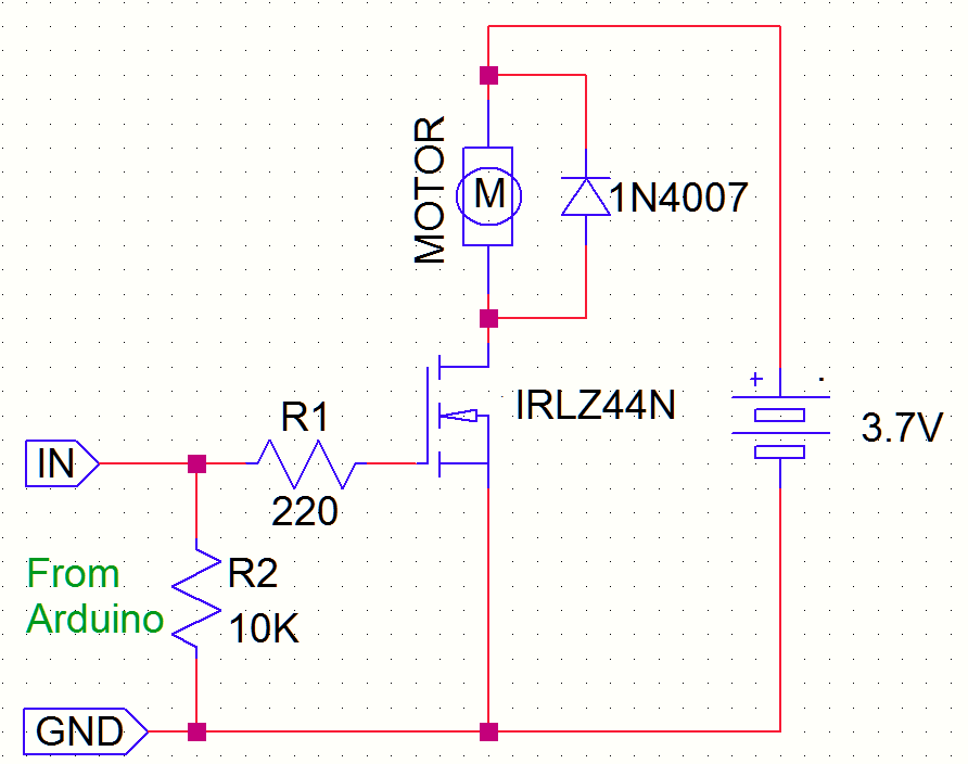

I finally completed the project. I'll write this for anyone who has this problem and comes across this forum. The IRFZ44n works okay, maybe it'll have a little voltage drop but it's acceptable for me, is there a better mosfet? yes sure, maybe in the future I'll try to experiment more but for now it's okay. One thing I noticed is there's a noticeable voltage drop after putting on the propeller which is predictable as you're basically applying torque, so the 8.4 dropped to 5.25 which is still okay as I adjusted the pwm to my code accordingly. This is the connection for anyone interested.

Now you need to do and post a proper schematic showing your real components.
You already have been told to use the IRLZ44 (note the "L" for "logic level").
The IRFZ is unsuitable to be used with a microprocessor.

I'm sorry, I'm not really familiar with any website that can do a schematic other than tinkercad.
Hi, @Wall-E_2_5_8_8_5_2
I'm not a Tinker user, but I'm surprised that it doesn't have a proper schematic CAD feature.
Draw it by hand?
Tinkecad is fine
is this okay?
It's much better!
Where is the servo?

Do you understand the schematic?
I shared the schematic in this forum or did you mean in terms of the code? , I don't have access to IRLZ44n in my country so I used IRF530N but it's the same idea. Anyways I already completed my project and it works properly if you have any questions let me know and I`ll try to help.
