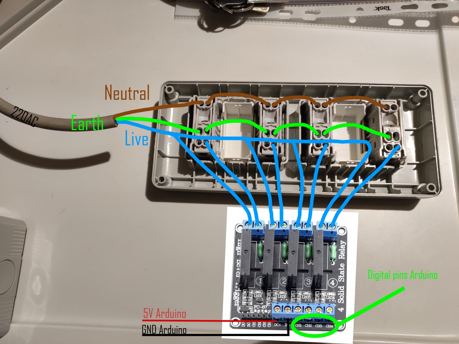

Hi everyone. For my "meat aging machine" project I need to turn on and off multiple devices remotely according to the value of temperature ad humidity read by a sensor. I want to make a power strip with 4 outlets. I want to control each of those with a solid state relay (I have a module of 4). Is it safe to wire it like I show in the figure below? The solid state relay module will be in a separate box and Arduino will be in a third box. My concern is about those 5V, GND and signal cables that go from the 220AC box, where the relay module is, to the 5V Arduino box. Is there any way to wire this more safely? Sorry for my ignorance,
I'm here to ask you since I don't want to hurt myself. Thank you very much in advance.
Please post schematics and code, all acoording to How to get the best out of this forum - Using Arduino / IDE 1.x - Arduino Forum
Are those AC or DC relays?
It should be safe the way you have it.
What is the Amp rating of those SSRs? What is the maximum Amperage of the loads you are connecting?
I was thinking the brown wire is usually LINE (hot) and blue wire NEUTRAL, be careful of polarity.

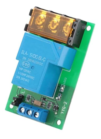

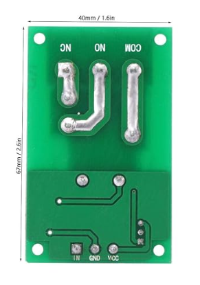

I'd prefer to use a ready-made breakout board because they're already well isolated with optocouplers. Will this be a good choice? It's rated for 30A. I can't find any board with OACM-5H, so I will have to solder a board with optocoupler and transistor to drive it, but i prefer not to do it and trust the work of people that are more qualified than I am :sweat_smile:

That would be my choice if you can tolerate the clicking, but I would replace the cheapy Songle relay with a name brand like Omron or Potter & Brumfield.
https://www.te.com/usa-en/product-1-1423091-8.datasheet.pdf
I can find only Songle relays on those ready-made boards..
The large SSR is the equivalent of your ready-made board. The logic to turn on-off may be opposite of the ready-made board.
Hi again everyone. I ordered the relay board above, rated 30A 250VAC from Aliexpress. Now I've read a bit about switching inductive loads with relays, spikes, electrical arcs etc. I'm a little bit concerned about switching the refrigerator with that board since I don't want to damage it and I don't want to take useless risks. If the board is opto-isolated, is there any risk of making Arduino going live? I've read about snubber circuits, is this one of the case in which you would advise to implement one of those? Thank you very much
