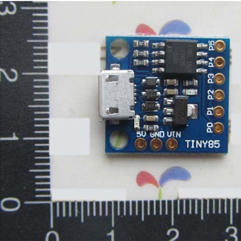

So... your circuit will have 3 ds18b20 sensors (requiring 1 Arduino pin) and one pin for the fan pwm inputs? Perhaps an attiny85 would be adequate (need to verify that the 1-wire and Dallas temp libraries will work on the tiny). But security of the connections is a concern. What type of connector would you prefer? Something with a catch that cannot easily shake loose? But won't USB shake loose?
How about one of those "digispark" boards? I've never used one, but they look pretty small. Need to find a way to attach connectors though.

To the developer of my favourite tiny cores, all is forgiven.
