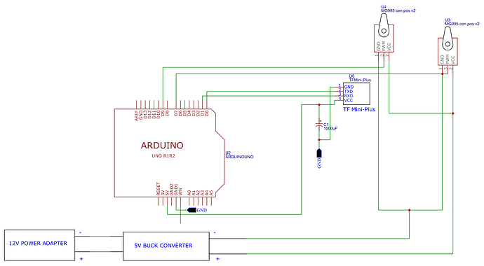

I'm working on a project where we use 2 mg996 servo and tfmini plus lidar to map a room. But when we wrote a code the vertical servo is shaking. When lidar is not connected there is no shaking. I heard that the shaking is because the vertical servo is idle for a long time while collecting the lidar value and can be avoided by providing the angle value as a 20ms period pwm to the vertical servo(Not sure if that's what they meant).But i dont understand how to create a pwm such that there is no stopping in the code execution in collecting value from the lidar. Here's the code snippet of both servo writing and lidar reading. Can someone tell me what to do.

Please post scematics. Powering issues are suspected.

I added a 100uF caps for the lidar .....cause i didn't had a 1000uF one. is that a problem?

Thanks for the schematics.
Powering the lidar from controller 5 volt is No, no. I fear it draws too much current. Use the bucket 5 volt.

The problem is with software serial. It can disable interupts for long periods so it will also disable the servo outputs.
Your diagram is wrong if you are actually using software serial and not hardware serial.
You might try altsoftserial but you must go slower than 115200
we used 7805 regulator to power it...but still the issue remains

It's good for 1 Amp. How is the 7805 powered? Any heatsink used?

the 7805 is powered from the same 12V power adapter. There is no heat sink
That's the problem when you only have one hardware serial port.
If you connect the LIDAR to it then anything you send to the serial monitor will also go to the LIDAR.
