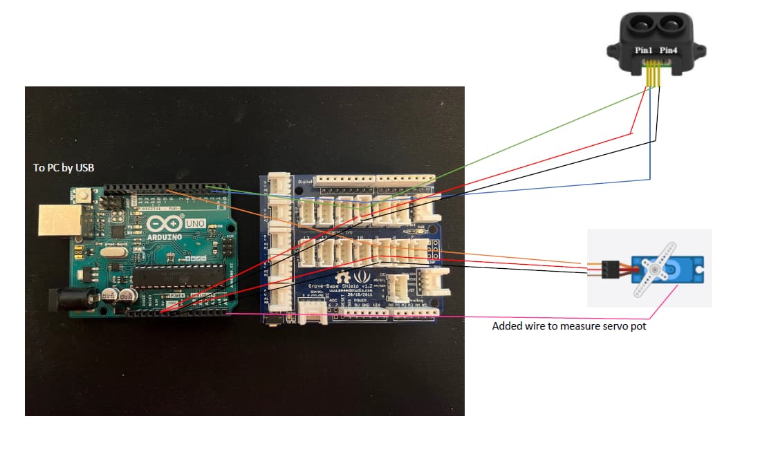

I added a power supply from the AC outlet using the wire you can see on the pictures below which goes directly in the arduino outlet.
This new power source isn't represented on the schematic and neither is the usb cable (you can see both in the picture).
Here are the new schematic and a clear picture of my wiring:

Your external supply is connected to the power plug on the Uno. That feeds the weak onboard 5V regulator. The 5V regulator cannot supply sufficient current for the servo so the servo twitches. The servo's motor pulls stall current every time that it starts and it starts a lot while trying to maintain position. Connect the servo to that power supply as shown in post #11 so the the external supply is powering the servo, not the puny on board regulator.
Is there a way to connect an external supply to that shield so that the shield supplies the servos? Can you post a data sheet, schematic or technical documentation on the sheild?
If the USB lead was still plugged in, then the power would still have come from USB.
The DC socket needs at least 7volt for the Uno to change from USB to DC socket supply.
That V1.2 shield has no option for external power.
According to the Eagle files I found, all white sockets are powered from the Uo's 5volt rail.
