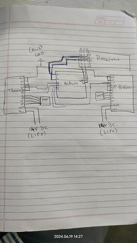

I want to control two stepper motors using flysky fs-i6 rc on two different channels .I am using tb6600 motor drivers for each stepper motor nema 23 and nema 17 are my stepper motor.I am using arduino uno as m microcontroller and i have flysky fs-i6 transmitter and fsia6b receiver. I am able to control single motor easily by the code i am using however when it coms to controlling two stepper motors only of them receive signals from the channel of transmitter via receiver while the other doesnt receive signal because of which there is no stepper motor moment . I am a newbie and i wish some could help me solve my problem by letting me know what exact changes shall i make . Below is the code which i am using for two stepper motors controlling using rc

this is the basic circuit diagram i am following , the only difference is i am supplying seperate power supply to both motors via motor drivers

Also you diagram is quite fuzzy, can you make a bettor one?
I think you may have it wired wrong?
Please don't use screen shots.

This maybe helpful ....I k the drawing aint that great but this is the wiring circuit i m doing. I am connecting tb6600 driver 1 step(pul+) to 9 and dir+ to 6 and i am connecting another tb6600 step and dir to pin 11 and 10 ....in the code i am directly mentioning the pins in stepper my stepper(stepsPerRevolution , 6, 9) these lines and in setup i am defining them as digital write with low parameter
Ok sir I understood one thing from the changes i made as per your suggestion ......the pulsewidth at channel 2 is coming zero while the pulsewidth at channel one is perfectly fluctuating .....Also whichever channel pin i am connecting at digital pin 2 of arduino that channel gives signal and the arduino receives it and the other digital pin whether it be 3, 4, 5(these pins i changed and checked ) at these pins the pulsewidth2 is coming zero and no signal is being transmitted

That Library is not for controlling a driver with STEP and DIR.
Most people use this library
can you please help me create the entire code because i am finding it difficult to change the library
After you install the AccelStepper library, try this code to make sure your steppers are working.
