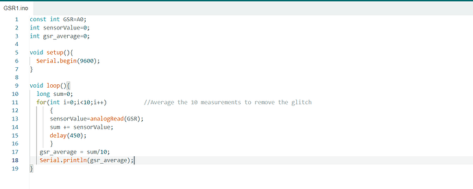

this is my setup and code
GSR sensor im using is v2.0
Im reading the values under serial monitor

I see that you ignored the advice to post your code using code tags. By doing that you have made it hard to read and impossible to copy for investigation. Do not post pictures of code or error messages
Then it is going to be difficult to provide help on converting the data
const int GSR=A0;
int sensorValue=0;
int gsr_average=0;
void setup(){
void loop(){
  long sum=0;
  for(int i=0;i<10;i++)           //Average the 10 measurements to remove the glitch
      sensorValue=analogRead(GSR);
      sum += sensorValue;
      delay(450);
   gsr_average = sum/10;
   Serial.println(gsr_average);
Resistance = ((1024+2*serial_port_reading)10000)/(serial_calibration-serial_port_reading)
i found this formula but when i used it i got resistance in negative
my serial_calibration value is 5
for example serial_port_reading = 11
((1024+2
11)*10000)/(5-11) = -1743333

const int gsrPin = A0;
const float V_ref = 5.0;
const int R_pullup = 10000;
  int rawValue = analogRead(gsrPin);
  float voltage = rawValue * (V_ref / 1023.0);
  float resistance = (V_ref / voltage - 1.0) * R_pullup;
  float conductance = 1.0 / resistance;
  float microSiemens = conductance * 1000000.0;
  Serial.print("Raw Value: ");
  Serial.println(rawValue);
  Serial.print("Voltage (V): ");
  Serial.println(voltage);
  Serial.print("Resistance (Ω): ");
  Serial.println(resistance);
  Serial.print("Conductance (µS): ");
  Serial.println(microSiemens);
  delay(5000); // Adjust delay as needed
this is the code i've used
