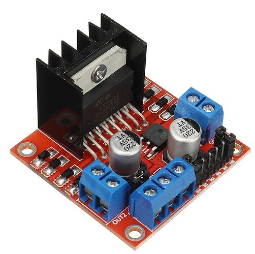

i have problems with my D5 on arduino uno. Im using this pin as pwm output to controll speed of motor. However my pin only gives around 2.9V insted of 5V when writing 255.

So lets guess this is the motor driver (this is how you provide a link)
Your diagram leads us to believe that D5 was connected to the driver board when you measured 2.9V.
Did you measure the output on D5 with the driver board disconnected?

I mesured it when connected and also disconnected, got same result. And also i mesured D6 with writeing same value. In case of D6 i got results as i expected.
