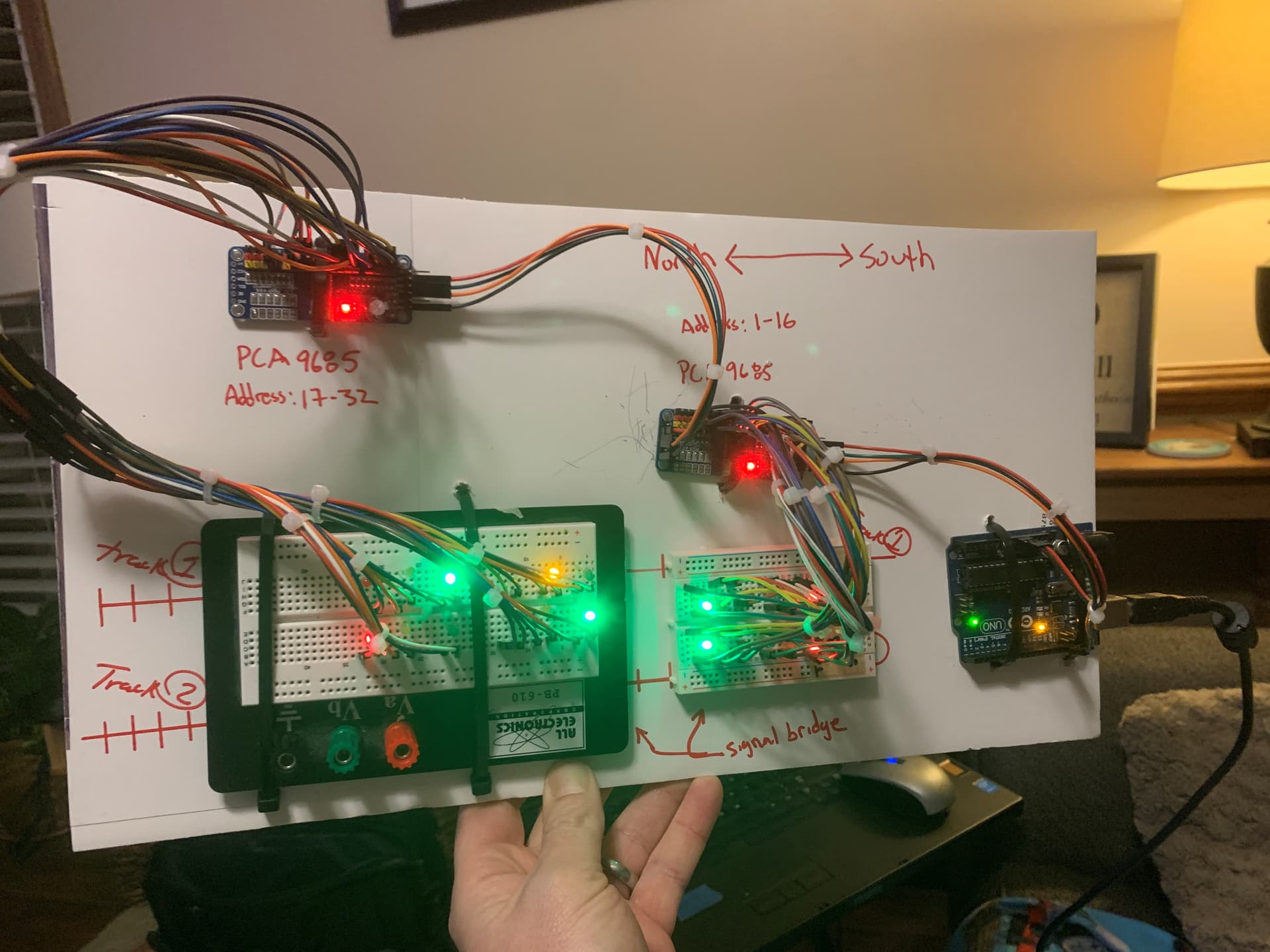

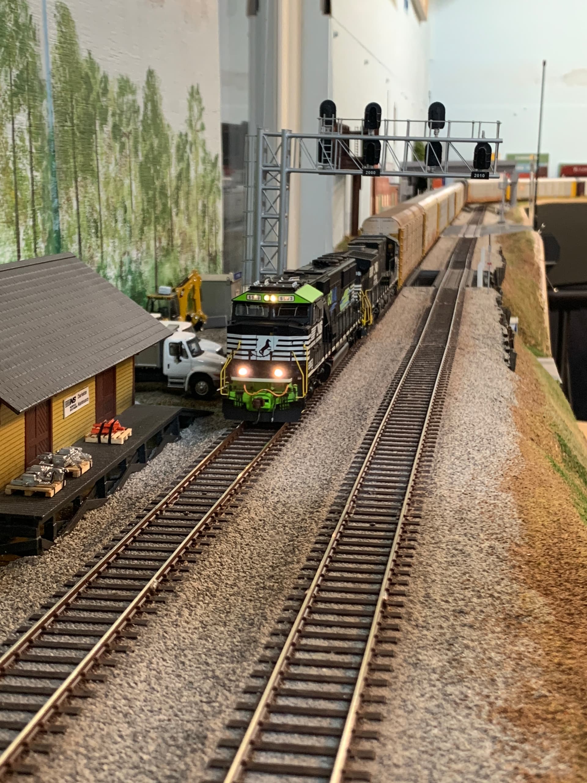

To help clarify the project, here is a picture of the signal structure I am attempting to animate. As well as a condensed wiring diagram. should I add a resistor in the terminal board to bridge the connection?
The last picture is a test board of the project to help weed out the bugs. The breadboard represents the signals that will be on the structure.
A PCA board has 3 different power connections, terminal block, Vcc and V+. "Just using the Arduino" doesn't exactly tell us much.
Steve
