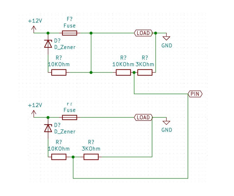

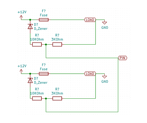

Could someone explain why this circuit would not work?
My understanding is:
when circuit is on and everything functioning the path of least resistance is through the fuse and the uC pin sees no or very low voltage. When the fuse blows a small amount of current will go through the zenner, which will protect for overvoltage, and then be divided down to 3v for the uC to detect. If any circuit is off it would not affect it and any circuit with a blown fuse will trigger the uC. What happens if 2 fuses blow? 2 signals the same, don't multiply?

With an intact fuse uC will see 12V because it is connected to the other side of the fuse, not good.
Tom... :slight_smile:

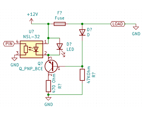

An alternative with optoisolators and transistor. Would this work if added to all circuits and to one pin?

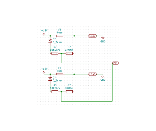

If I connect direct to ground would the load resistance not affect the calculations and potentially drive current through the indicator side of the circuit? I.e. if the fuse is intact, circuit on, and resistive load I would get a false indication. I suppose i could use a diode to prevent the 12v going down the post fuse branch of the indicator circuit.
What about the top version of this?
I think I am getting a bit confused, back to drawing board!
I think I will go with this solution and just parallel a number of them to the uC pin. That way if any fuse blows the uC pin will be drawn to ground and detect the blown fuse. I have inserted an additional LED in parallel with the optocoupler as an additional and more local indicator. So, if it works the uC will be able to send a message to the user that a fuse is blown in node x and then when the user opens node x they will find an led to indicate which fuse is blown. I will have to match the led forward voltage to the optocoupler. Alternatively I could move the resistor and add another one.
This diagram should show why your idea will not be good, the high input impedance of the analog input will mean almost no current flows, so no voltdrop.
Tom.... :slight_smile:
Yes, the voltage divider method got away from me! I have changed to a PNP transistor driving an optoisolator now. I think that should work. I will do the calcs for the components and breadboard it first but need some optoisolators.
