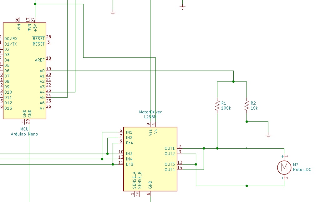

Can someone help me configure this code to properly run a dc motor via a L298N?
Basically, the way the DC motor is connected seems unnecessary and I could not get it to work properly. I now have the DC motor connected directly to OUT1 and OUT2, then EnA to D10, In1 to D9, and In2 to D8.
My question is, how do I change the code to reflect this? It looks like I need to change motorPWM to 10. What about voltPin A0? Since I scrapped the schematic way, what changes do I need to make? Any help would be appreciated. Thank you.

What is the motor voltage supply?
What is t he purpose of A0 analog input?
Can I suggest you for the moment, dump that code, and write some code that JUST tries to run the motor, nothing else, this will make sure you have control before adding encoders etc.
Can you please post a link to data/specs of your motor?
Your circuit appears to be part of a bigger assembly, can I also suggest you JUST make a circuit that only concerns the motor and the 289, there are more efficient motor drivers around but it will work.
The motor is a 12v DC motor, rated current 2A.
I did run a test where it was just the dc motor, l298n and arduino and it worked great.
I’m not really sure the point of the A0 pin and I don’t really know enough about code to do it myself. I was hoping I could just change the pins and delete the A0 and be good to go but it’s not responding to the encoder. I have tested everything Independently and it works, but I just can’t get the encoder to control the dc motor for the life of me.
You cannot read motor voltage like that, motor voltage is pulsating 0V to 12V at the PWM frequency, (980Hz in your case). Use the pulse count from the encoder to compute speed.
Connecting one of the outputs of the L298 to ground is a sure way of killing it.

I think this is what you are trying to achieve with the potential divider and A0;
Tom... :smiley: :coffee: :australia:
I believe the L298 outputs can be paralleled as long as correct polarity is maintained, but the motor speed cannot be obtained by reading the pulsating voltage with analogRead. Also, the L298N does not have kickback diodes, is yours on a module or a bare IC?

Here is a picture of the entire schematic:
