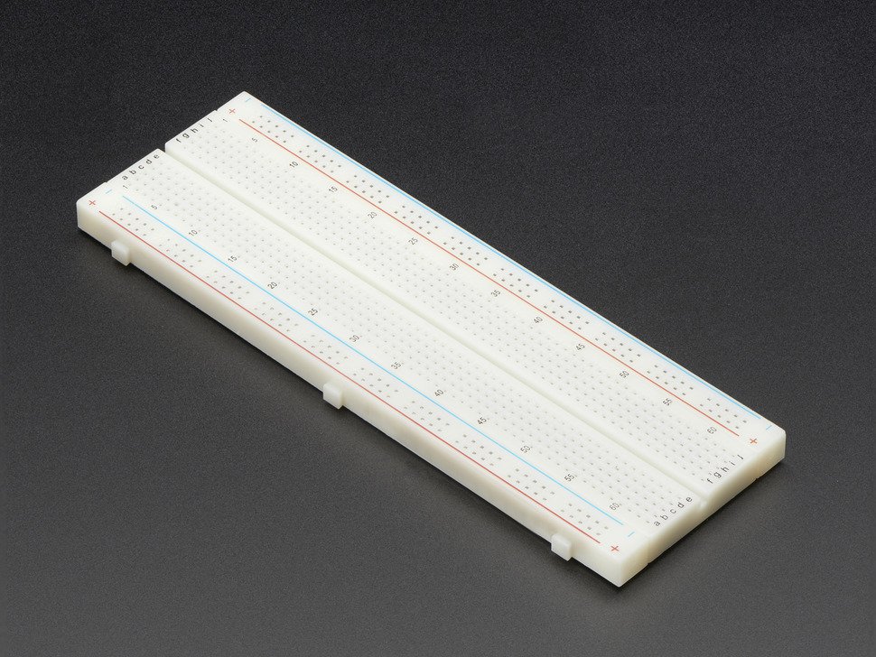

Some breadboard have red and blue power buses that are not connected in the middle.
You have to put a jumper in the middle of each of the buses to connect the left side to the right side. This is done to allow the user to run a 5V circuit on the left half while running a 12V circuit on the right half. The problem is that not everyone knows this and without the jumper in the middle all the circuitry on one side will be "dead"
Ah yes, thanks, I've certainly made sure they're connected up.
