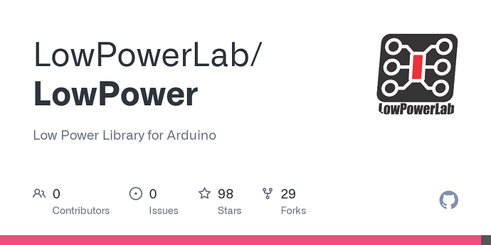

I have used the following low power/sleep library with great success;

Just use one of the low power libraries, like that linked above. Start by studying the docs and examples that come with it. Very simple to use.

Hey Mark, this looks very promising! Thanks for putting me on to ie.
