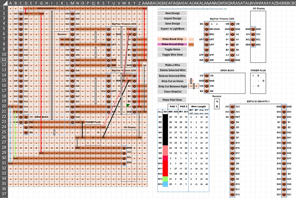

I wanted a design tool to aid in this process, and I used the macro language embedded in Microsoft Excel for that. Picture 1 shows the first sheet of the macro-enabled Excel tool, for a project having an ESP32 S3 DevKitC-1, two BigTree Trinamic 2209 driver boards for stepper motors, a BROK buck converter, and a small I2C display showing the IP address of the user interface for the project.
The left section of the pic shows the layout of the stripboard, with portions of the strips that are part of a circuit in the darker color. Strip cuts either over or between holes are shown, as are the colored interconnect wires.
The mostly grey boxes to the right of the design area serve as command links to various macros. The top four (New, Import, Save and Export) are file commands. The middle four boxes are for maintenance of the design area visuals. The next six command boxes are associated with wire making and strip cutting. The bottom Make Print View command first creates a top and bottom view of the design area on a separate Excel sheet, then formats and prints the pair in landscape mode, handy for use during actual soldering.
Below the commands, a table of wires showing wire color, starting and ending solder pads, and the length of wires (mm) needed for the connections, calculated for two different routings. Clicking on any of the colored boxes brings up a dialog to change the wire color.
The other items on the right side of the pic are taken from other sheets in the Excel file, which have additional information (pinout diagrams, pin usage guides, Amazon order links, pin assignments, personal notes etc.).

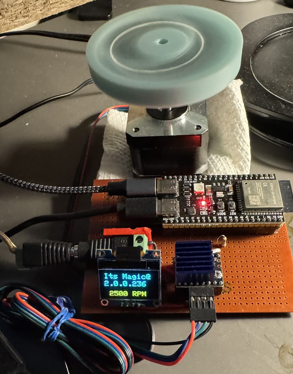

Finally, here’s a picture of a version of the design I made with only one BigTree, with the NEMA 17 stepper running at 2500 RPM, as shown on the display. I think it can go faster, but I chickened out because of worry about the flywheel structural integrity.

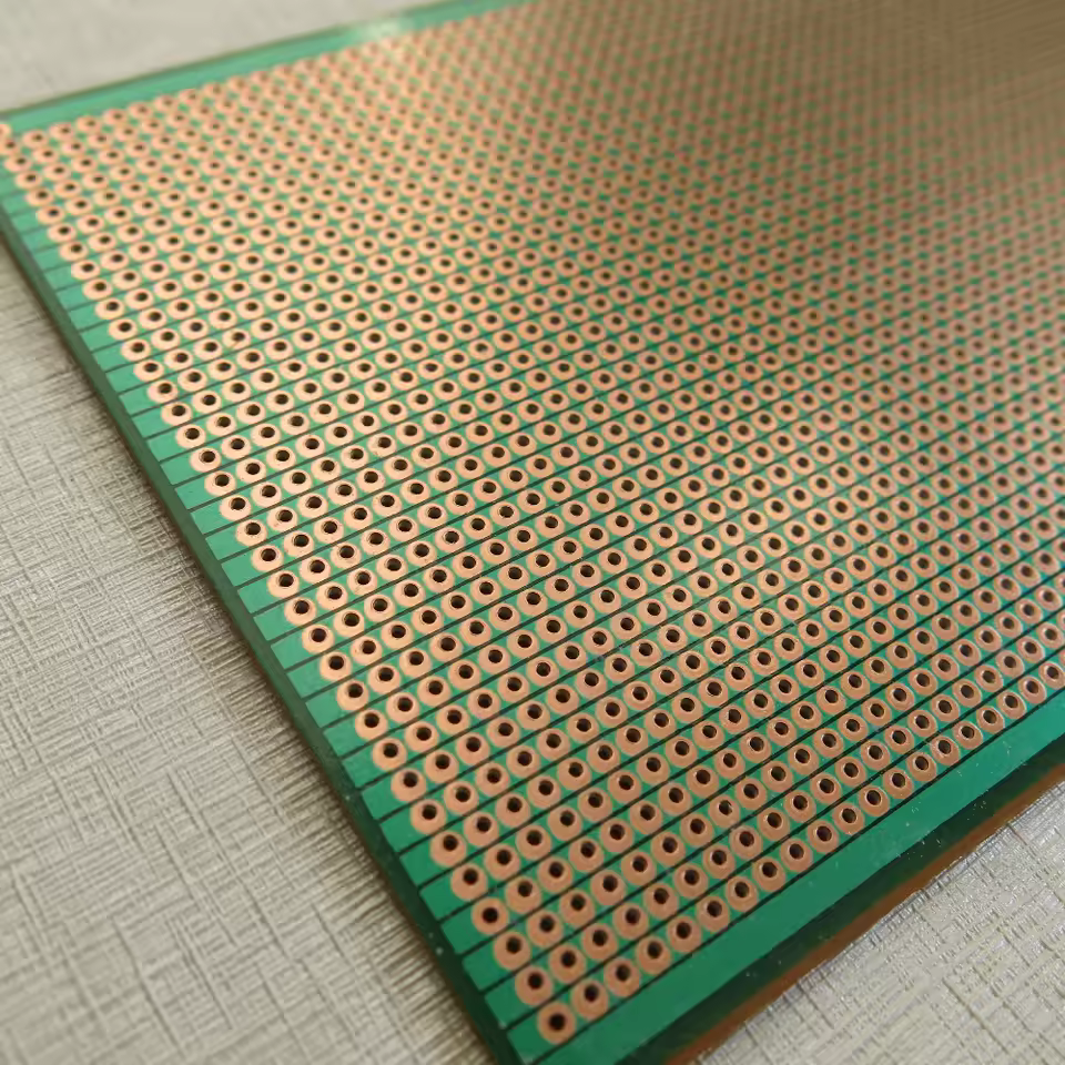

Stripboard can be challenging to get clean joints due to the way the solder likes to wick down the tracks. There is a type of stripboard that has solder mask over the tracks, providing the type of "pads" we are accustomed to soldering on standard PCBs. I find this type of stripboard to be much more pleasant to work with:
I purchased mine from AliExpress. I don't generally recommend AliExpress since I have had bad experiences (I stopped using it some time after I purchased a stock of stripboard). I would guess you can find the same product on alternative marketplaces like eBay and Amazon.

I've developed my own prototype strip board, partially inspired by an Adafruit design. The tracks are easy to cut, where not required, and solder does not flow across the strip.
Rear side. No solder mask except around the perimeter:
Front side. The solder mask is actually white and the silk screen markings in black. On this side, there are no copper tracks between the pads. The lines shown between the pads are only silkscreen markings:

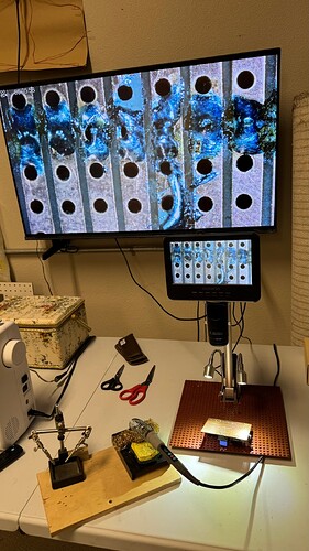

So I followed your advice and shopped strip board with solder mask (Amazon), to see if I could get better solder joints. First pic is a redo of my project with the new board. Given my declining eyesight, I now solder with the aid of a video microscope (second pic, foreground) and inspect on a 43” 4k TV (background). The solder mask joints look much, much better, so thanks for the tip!
