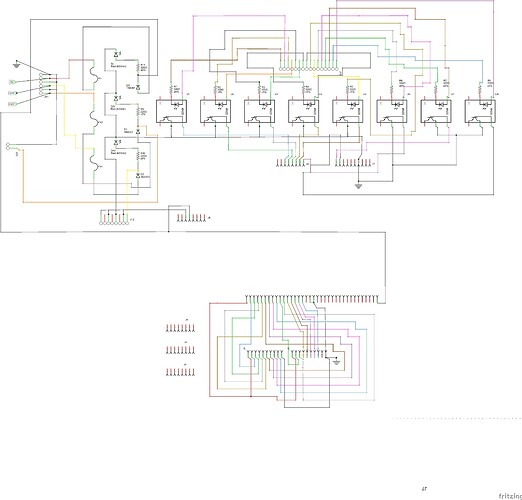

I am quite new at schematic drawings for electronics and i would like hopefully some people who are good at to provide me with some tips and guidance. I will post my latest schematic here (yes it was made with Fritzing, hopefully you can still help, without telling me to change software yet). This is quite new to me, and I look at it and realise, there must be a better way to do it. ie: standard placings, wire routing conventions, should i use different colours etc? any advise is greatly appreciated. This circuit is basically for a breakout board for a Mega. it has seperate 5, 12 and 24V supplies to the board. 5Volts for the Mega, 12Volts to feed the relay board and 24V to power the existing 24 switches.

The diagram is very confusing (to me).
Optos normally don't have the base connected, just collector and emitter.
LED current limiting resistor values are too low (220ohm on a 24volt supply is 100mA).
Leo..
Normally yes, but for frequency response you add a higher valued resistor to ground.
While that diagram is one of the better ones I have seen from Fritzing it is still very bad.
First off are the lack of labels, especially all that stuff at the bottom of the page, I have no idea what that means. Connections plugs and sockets should have each connection labeled so you know what they are.
Next the opto couplers need to be rotated by 90o to the left, and as mentioned they are wired up wrong.
Line crossing should be minimised, look for example at F5, if you swap over the connections then the wire from it would not have to make a crossing. Same for D3 if it were placed above R11 then that wire to it would not have to cross anything. This is simply poor layout of the components and results in a tangle of wiring that is very hard to read.
The aim of a schematic is to convey the circuit in a simple to read layout.
There are some general rules that also help and while not being too strict about them you will produce a more clear diagram if you pay attention to them.
- Positive at the top and ground at the bottom.
- Inputs on the left, outputs on the right.
There is also a lot wrong with the left hand side you seem to have connected a 24V supply to a 12V supply only with a diode!
I'm not familiar with Fritzing, but in general I'd suggest...
Keep all signal lines horizontal or vertical.
Avoid unnecessary step changes from one to the other (top right looks very messy).
Space the diagram out (this can help to align things to reduce stepping).
Make sure there's a clear demarcation between the component and a connecting signal line (make component outlines much thicker for example).
Colour is unneccesary in a well drawn circuit diagram.
Don't overlap / cross components with signals.
Hope that helps!
A good effort with fritzy, but as Grumpy_Mike has said, it lacks numbering etc.

The problem with a dedicated drawing package is that most times it does not have the right symbol and a newcomer is too inexperienced to draw the right one. This results in substitute symbols being used which are even more confusing.
I would recommend just a simple 2D vector drawing package.

And make liberal use of the ground symbol, and Vcc nodes.
Check my signature for a couple of links. The key to a schematic is clarity.
