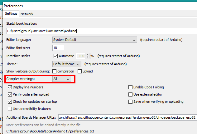

There is an extra ` at the end of that statement that is causing a warning. You do have compile warnings enabled in the IDE, File , Preferences, don't you. It is important to know of and deal with warnings.
