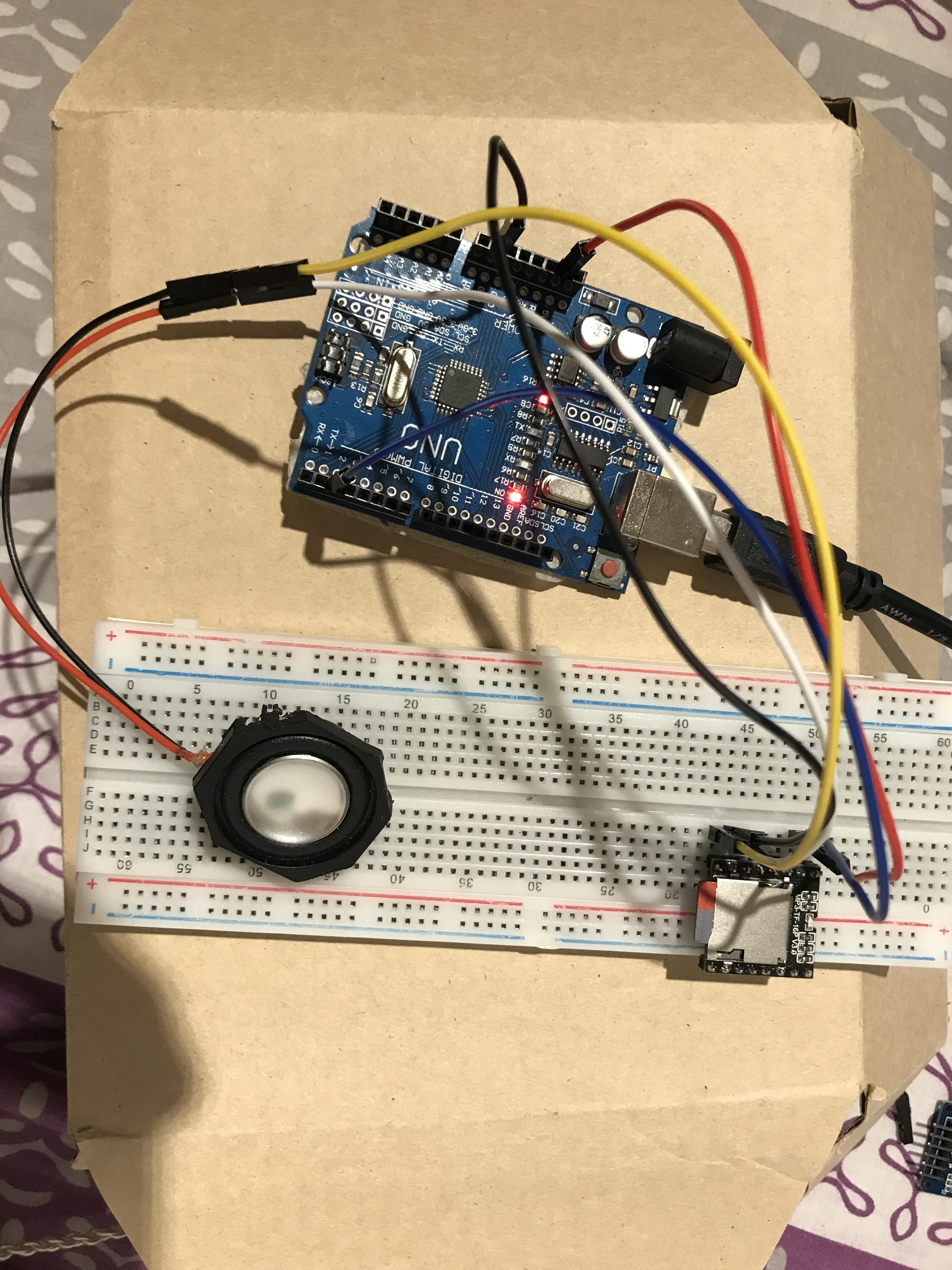

It’s a DFPlayer Mini. It has two serial communication pins, TX and RX. I was wondering if I can make it work with only one pin so i just send the commands from the arduino. I don’t care to receive information from the module. Would this be possible? Thanks

I am sorry. Here’s some more information.
This is the connection of the arduino and the module.
Arduino -> DFPlayer
5v -> VCC
GND -> GND
D2 -> RX
And the speakers accordingy.
The right pin column of the module is not connected to neither + or - rail. I put it there because it doesnt fit other way in my breadboard.
And here’s the code I’m trying to run:

The audio file is maybe 1 second long so i guess it has time to wait that 4 seconds delay and play it again. I can't get it to work.
Thanks for the extra information. Now I am wondering why you asked the question. You could easily connect Uno pin 3 to the Tx pin of the player to find out if the one-way communication was the cause of the problem or not. Have you not done that? If you have done that, and it made no difference, why are you asking if one-way communication is the cause of the problem?
Anyway, do you see the blue led light up on the player when the audio track begins to play? Does the led go off after 1 second? Does it light up again 3 seconds after that?
Yes, sorry for not specifying that. That same code does indeed work when the TX pin is engaged.
When TX pin is not connected no, it does not turn on again. But of course when it is connected it works.
I'm using a Uno board, maybe that's part of the problem? You said that it worked to you but in a different board. I hope I can get this to work. I already spent hours with this.
Thanks for the help!
I finally found a solution. I used another library. I was using <DFRobotDFPlayerMini.h>
and changed to <DFPlayerMini_Fast.h> and it works like a charm.
The library you were using sends requests for information to the module which won’t work if you don’t have Rx

You tell it not to. I had forgotten that I had done this in my code:
 myDFPlayer.begin(Serial1, /*isACK = */false, /*doReset = */true);  //set Serial1 for DFPlayer-mini mp3 module
