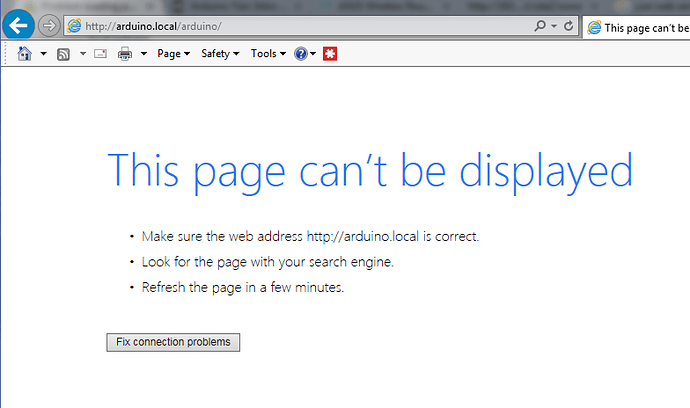

However, the web server does not appear to be running. For example, http://local.arduino cannot reach the Yun ("server not found" error).

I started from scratch and reloaded the openwrt-ar71xx-generic-yun-16M-squashfs-sysupgrade.bin image. Yun is working fine now.
Except the http://arduino.local still comes back with "server not found".
local server has always tended to be a little hit and miss but via the YUN's IP seems to be the most reliable method.
Same thing in a different manner.
The arduino.local issue is easy to fix - once you know how!
You must install Bonjour for Windows, see here arduino.local doesn't work - Arduino Yún - Arduino Forum
zzyzxx:

It's not hit and miss or any mystery .
.local domains use multicast DNS. Either your network, operating system, or browser is not supporting mDNS very well:
