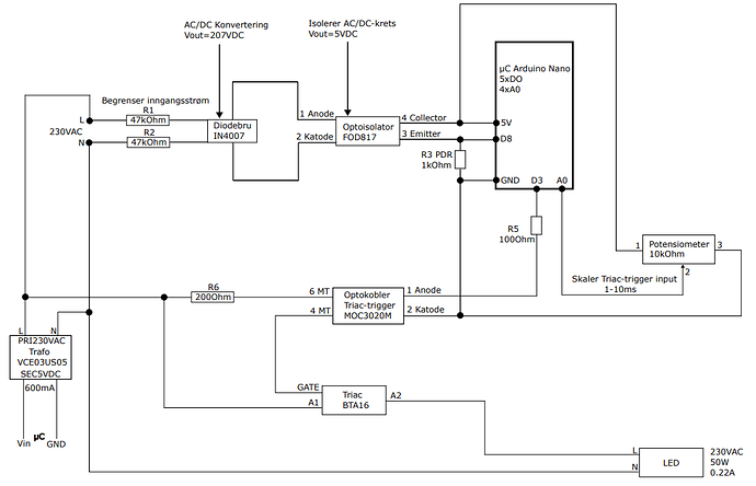

Hi community,
Im trying to dim a LED using zero cross detection, but cant make it work.
Here is my connection diagram, exept i havent used the trafo yet.

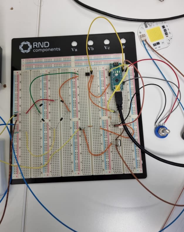

Here is my phsyical connection:
I am coder so I use electronic modules. I will not comment on the circuit.
