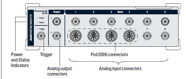

I want to send a signal from the arduino to a PowerLab recording unit (i.e. PowerLab 8/35) that has two types of analog input connectors: (1) BNC connectors and (2) Pod (DIN) connectors.
I was just wondering what would be the best cable to purchase for this purpose.
I apologize if this is a dumb question - I'm still kind of new at this.

A picture of the unit's panel is attached, as well as its lab manual. Here's a website link to the unit: PowerLab (DAQ) Data Acquisition Hardware Device | DAQ Equipment | ADI
The arduino and computer are already hooked up to each other, as well as to an additional laser source. I just wanted to add an additional element to the code. More specifically, I want the arduino to send a trigger to this program whenever the LED light is on.

Page 31 shows the trigger connection as a BNC connector but you asked about a DIN connector. The analogue inputs pin out is shown on page 32.
There is this 8 pin DIN but you will have to solder a wire to it.
As mentioned before you could cut a cable in half like this one https://www.ebay.co.uk/itm/FULLY-WIRED-MK2-Powerlink-8-pin-din-Speaker-Cable-FITS-Bang-Olufsen-BEOLAB-1M/292213283354
But then you would have to find the wires you want by using a continuity meter. Note that this cable is described as "fully wired" which means there is a wire connected to each pin. It is possible to get cables that have only a few wires connected up for a specific application but these never seem to say "partially wired".
