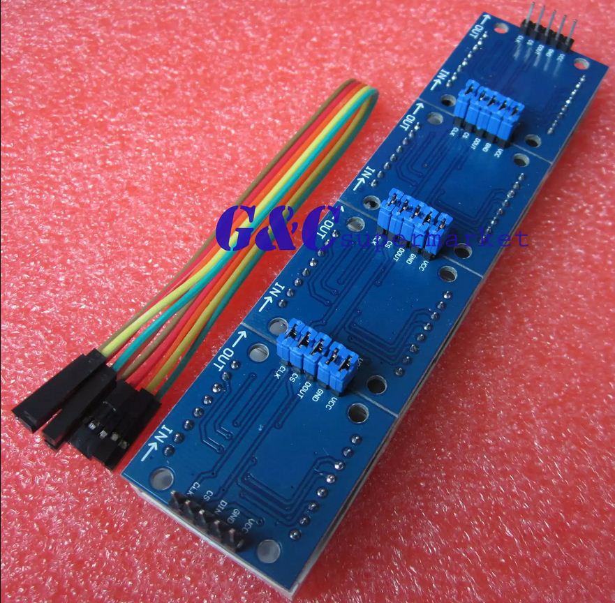

but i have 4 MAX7219 dot matrix module one display each 4 of them are display the character and it is inverted. any idea how i can change zat

Read the documentation for the library, especially around the use of different types of hardware.
hmmm i did read the documentation as you mention but could figure it out.
don't know what i miss in that
The matrix is wired a lot of different ways depending on the hardware design. The library needs to know how it is wired up.
  1. Determine what type of hardware you have from the supported list. I think you may have FC-16 from the picture you provided, but the documentation has a number of images to try and help you decide.
  2. If yours is non-standard then you need to understand what the setting will be using the HW_Mapper example software.
  3. Change the library defines to suit your findings from either 1 or 2 above.
Here is a link to an instructable from someone who has used the library in a project that may help - just jump to the part that shows how to change the hardware setup in the library - http://www.instructables.com/id/Arduino-Parola-Zone-Time-Msg-Display/
thanks a lot it works :smiley: :smiley: :smiley:
