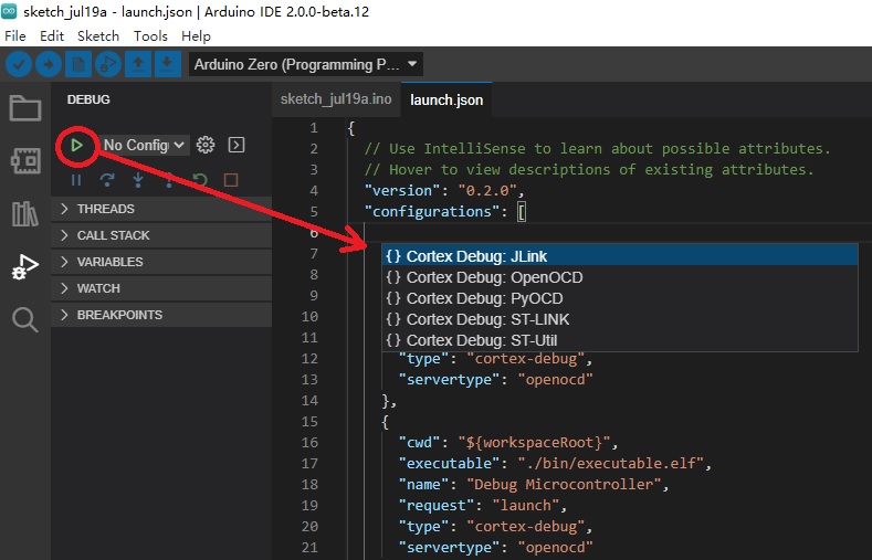

Hi, I get the transfer line today, and test the "arduino ide 2.0 + daplink + arduino m0":
and find that the arduino ide 2.0 can not recognize the daplink, so arduino m0 can not be recognized too, so the live debugger isn't be launched. I noticed that there is a "launch.json" appeared when click the "Start Debugging" button:
I don't know how to configure the launch.json file, so the test failed. Can you help me?

Please provide a detailed description of what you mean by "can not recognize". Include the full and exact text of any error or warning messages you encounter.
I believe that the launch.json file is completely ignored. Instead, for debug probes that need a custom configuration, you should use the debug_custom.json file, as described here:
https://docs.arduino.cc/tutorials/mkr-wifi-1010/mkr-jlink-setup#debugging-in-arduino-ide-20
(but note that exact configuration is for j-link and almost certainly can't be used for Daplink).

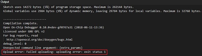

Hi, I choose the board, port, programmer as follows:
1
Clicking the "Get Board Info", then the board information getted:
2
Then I upload the sketch, an error occured:
Because daplink is not supported by arduino ide 2.0:
5
so I think the errors when uploading are unavoidable, unless daplink is supported by arduino ide 2.0
Then I click the "Start Debugging" button, the following appeared:
It seems that something has to be configured.
The arduino ide 2.0 is not as good as platformio, platformio support daplink, just one click when debugging arduino m0. It is very friendly for the students.
I think there is a very long way for arduino ide 2.0
