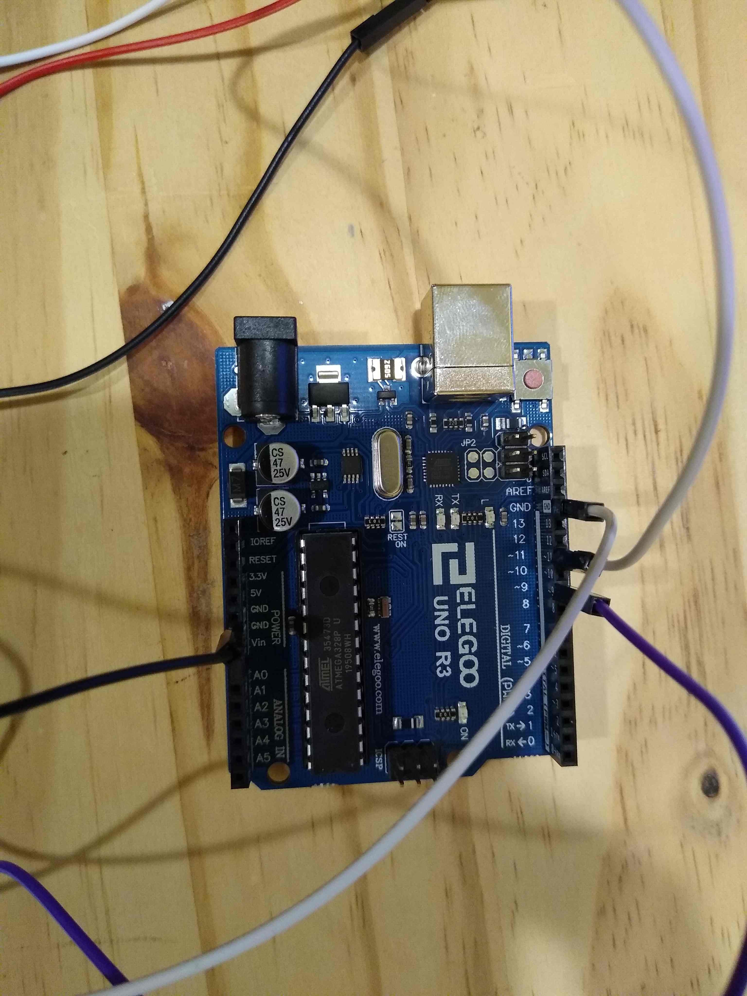

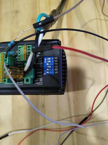

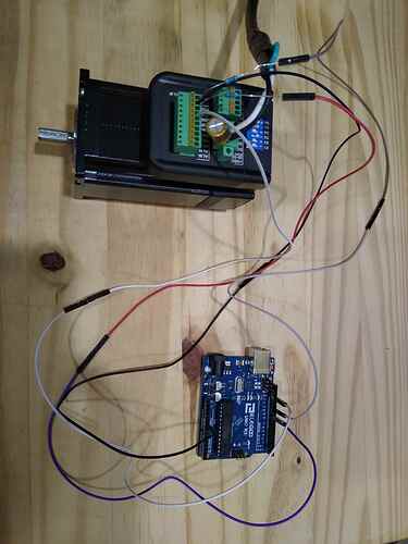

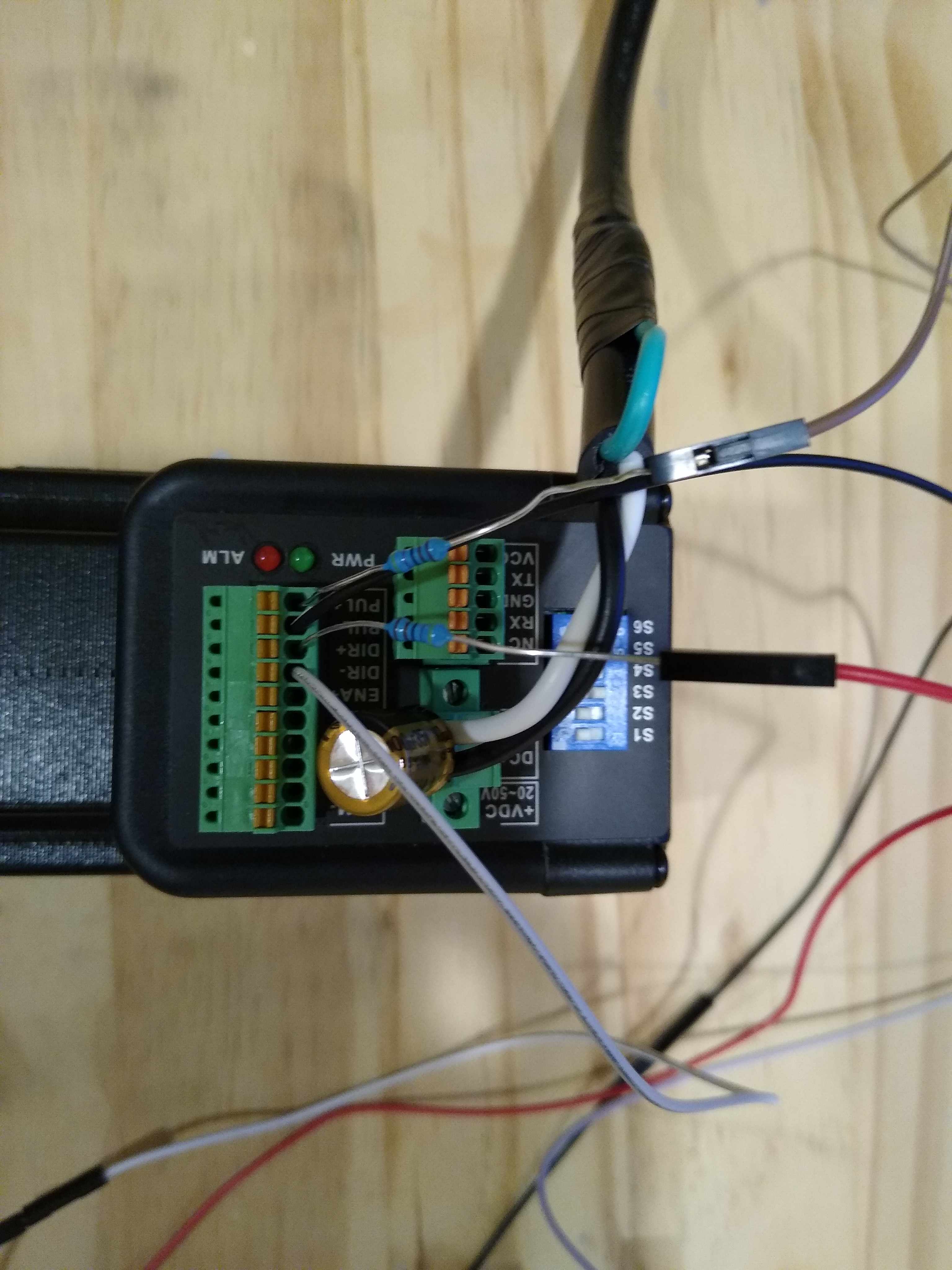

I tried following the tutorials the kit provides, but when I tried to control the "TOAUTO Nema23 Stepper Motor" with the UNO R3 it didn't rotate or anything. I connected the PUL+ and DIR+ with 4.7K resistors to pins 11 and 9 on the UNO R3. The PUL- and DIR- are connected to Ground. The motor itself is powered by a 36V power supply with a 100uf capacitor. The motor is set to 6400 steps.
I included pictures of how I wired everything.

The Arduino Stepper library cannot control a "step / dir" type drive, you can install the AccelStepper library from the IDE library manager or try @Robin2's simple stepper program.
Simple Stepper
Those 4k7 resistors MAY not be needed with 5V control voltage, post a link to drive's datasheet or user manual.
