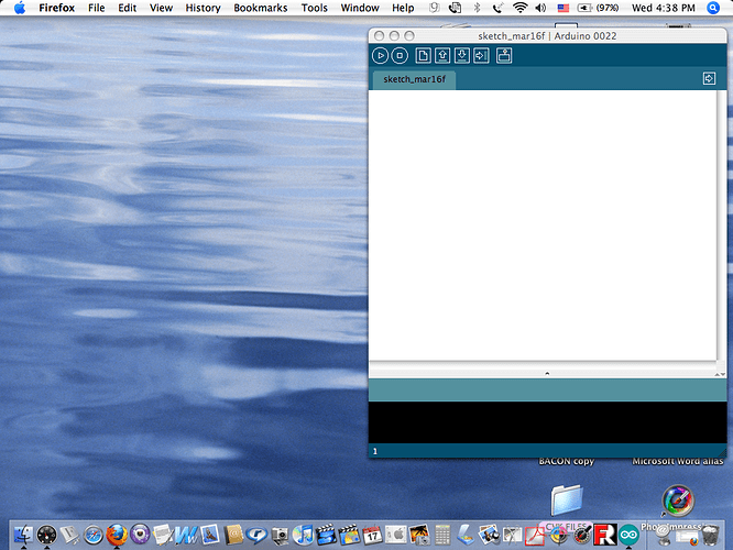

Can you post a screen shot of your screen?
Thanks.
Here is my screen - thanks!
I downloaded this today from http://arduino.cc/en/Main/Software under Mac OS X and that's what you get.
Notice how it says "Firefox" in the top left? This means Firefox is "active," or the currently running program. Therefore, Mac OSX will display the menu for Firefox. Click on the Arduino icon in your dock, and the Arduino app will become active. Now you should all the menus. To switch back to Firefox, click on it in the dock.
