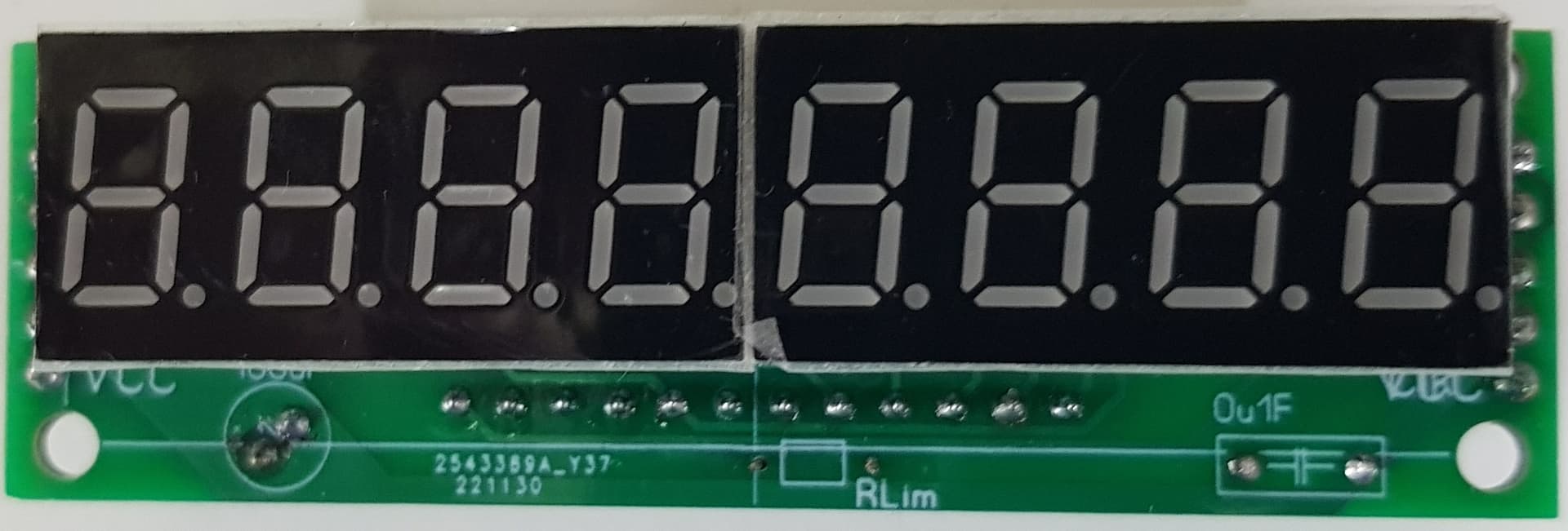

I have an application that requires an 8 digit 7 segmentLED display. I had intended to use a MAX7219 based eBay module for this purpose but after having purchased a few different types, I found that they were badly designed or shoddily built and required re-work to make them satisfactory. I found one module which was pretty close, but it was fitted with the wrong connector for my application. Normally I would just de-solder the connector and refit the one I wanted, but the hole diameter and pad size was such that I damaged the board in the removal process, even with being careful and using decent tools. Again messy re-work that looked bad and could fail.

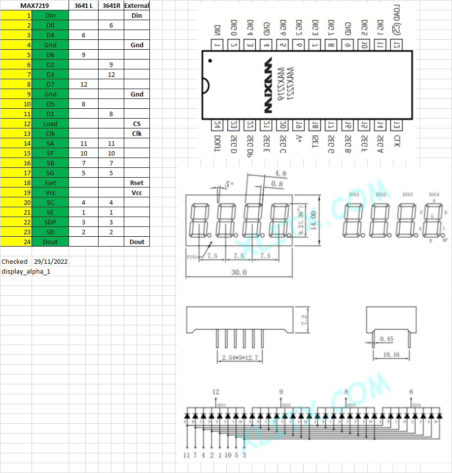

So I decided to design my own module and had my own printed boards made. While I don't consider myself a gun board designer, this is not my first board and is a pretty simple layout with the LED display modules on the front side and the MAX7219 on the back. I chose through hole style as my surface mount capability is not great. My board has an identical connector and mounting hole layout to the eBay board with the wrong connector noted above. The plan was to substitute mine for theirs in my project. Problem solved!

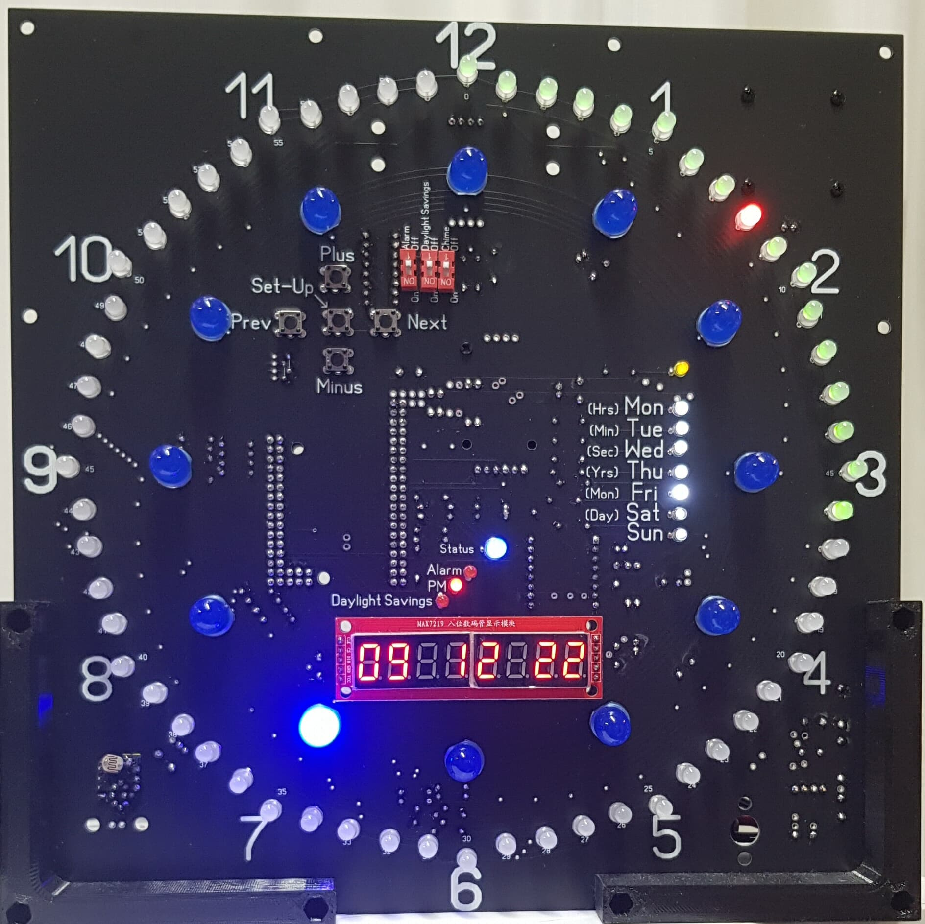

Secondly, I draw attention to the project which this query is part of. It is an "analogue" LED clock, pictured showing the date and time at: 07:08:16 PM on Friday 9 December 2022.
Clocks like this are not really new, this is just my take on it. In this instance, I have installed the eBay "red" pre-built module for this picture. The project is clearly working, if still in development. I want to make two points: 1) the PCB for the 7 segment LED module is nothing like as complex as the whole working clock PCB. 2) I am not phased by debugging a PCB. The first version of the clock board didn't work as intended, but after some debugging work, I was able to locate and fix the errors. I certainly don't have the hubris to believe that my PCB's never contain errors. The bi-colour outside LEDs are "Charlie-plexed" and I am really happy with the result.

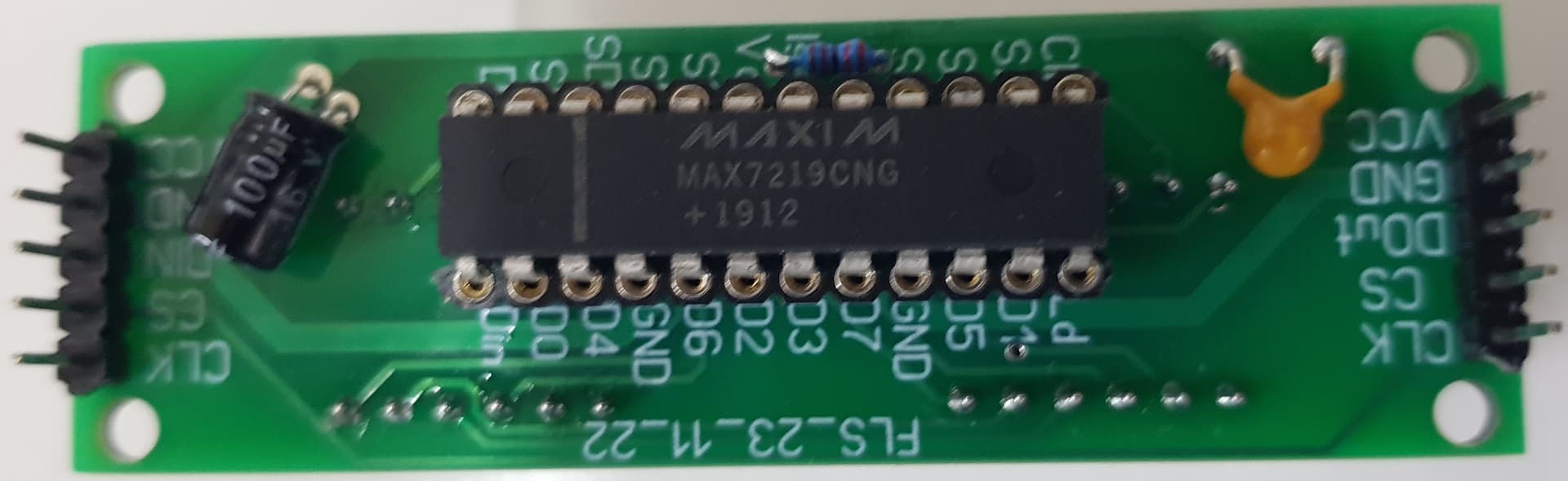

> IC closeup photo:
See photos attached of my green board. These MAX7219 share some identifiers to cloned devices, and all devices I have are marked the same. But at least they spell MAXIM correctly, unlike on the red eBay board.
If you need better photos still, I will do my best.
> How did you design the circuit?:
I design all my circuits with reference to manufacturer data sheets. The data sheet I used has the reference number 19-4452; Rev 4; 7/03 at the top left of the first page and is attached for perusal. I did not draw a formal circuit as I am basically using the same one as in the data sheet in the drawing "Typical application circuit" bottom right of the first page. Instead of a formal circuit I used a pin interconnection map. This map is included as the image pin_connections.jpg. My board has the same pinout to the external circuit as the red eBay board, so I could interchange them. As good practice, bypass capacitors are included on the board. Before you tell me I have transposed the connections to the MAX7219 remember it is mounted on the back of the board.

PCB layout is attached as a zip file containing the Gerbers and the drill file. I didn't know how else to post this. It is visible with any Gerber viewer. I use Sprint Layout for my PCBs.
display_alpha_1.zip (15.5 KB)

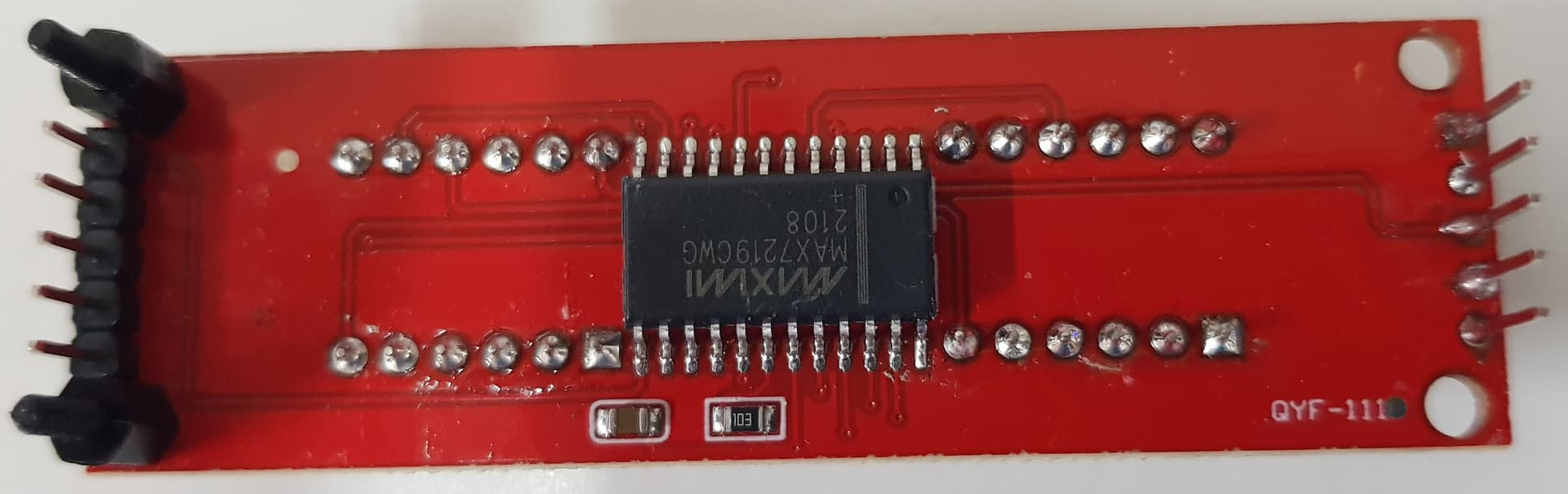

Finally, I have also posted some images of the eBay board, red in colour. Both back and front shots are shown. For reference only. Notice MAXIM is spelt MAXIMI.

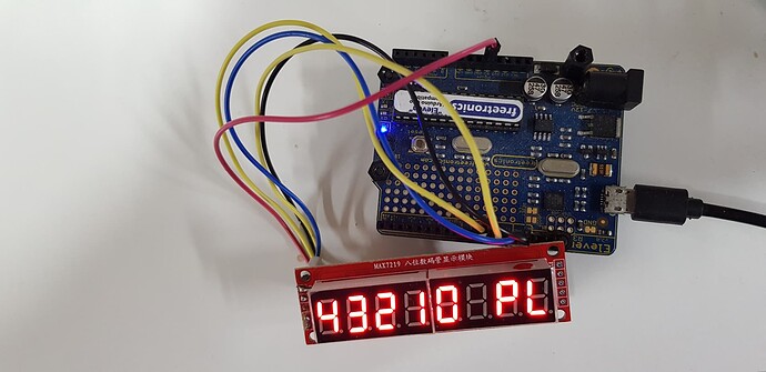

Here is a shot of my test jig with a working red eBay board under test:

Typo in co name screams knockoff. If they can't spell the name, you can be sure the silicon has errors (doesn’t fully meets specs). Bet that genuine parts perfom better.
