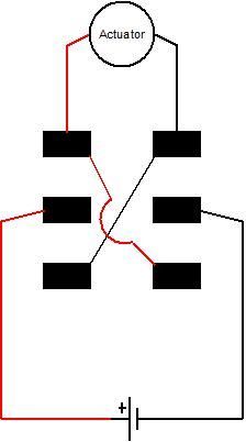

Hi, everyone! I posted a topic a while ago that was similar to this. Basically, I have decided now to use a dpdt momentary switch for an h bridge that I am using, instead of 4 buttons. I posted the schematic for that h bridge down below. I would ensure that only sw 2 and 3 can be on at a time, and only sw 1 and 4 can be on at a time. Thus, I can control the motor both ways. Now, instead of having all the buttons, I want to just have a dpdt momentary switch like this: Amazon.com
Here is the old schematic with the buttons: (Its called download.png)
Would this be an accurate schematic for wiring the new dpdt switch: (Its called dpdt.png)
Thanks for all your help!
EDIT: On the schematic I forgot to include vcc and gnd. Vcc is where the 2 diodes cathodes' are connected to, and what sw 1 and 3 also connect to. Basically gnd is at the bottom of the circuit, and vcc is at the top, but under the motor. I will post the new schematic below.

The switches you linked to are not rated for DC current and I have forgotten what your motor current is? There is a difference between switching AC or DC current even into a purely resistive load which a motor is not. Watch this video:
Toggle Switch 125V 20A Momentary Automatic Reset Switches 250V 15A DPDT ON -Off- ON 6 Terminal pin Rocker Switch with Metal Waterproof Cap (Pack of 2 pcs)
Nothing about the switch having a DC rating? Now again, what was the DC current load?
Not the best way to wire the switch - if one pole gets a welded contact and sticks in place, the other pole switching shorts the power supply. Best to wire just like the two separate SPDT switches (like post #8)

Its not just good practice, its essential. Here's the voltage from a smallish motor (cordless screwdriver I think,
about 2 inches long), with 12V from a (fairly flat) 10xAA NiMH pack brushed across the terminals.
Note the vertical scale is 50V/div, and the 'scope has measured a 264V pulse. That's bad news, even
though its very short. (For instance it can degrade insulation in the windings, and cause severe EMI to
surrouding circuitry).

Ya, I am leaning away from using dpdt switches. In that case, does anyone know a good h bridge circuit using 2 momentary push buttons that wont short circuit the power supply if they are both pushed?
"Ya, I am leaning away from using dpdt switches. In that case, does anyone know a good h bridge circuit using 2 momentary push buttons that wont short circuit the power supply if they are both pushed?"
Maybe wire them like the SPDT relays? I think that is the way most two button motor control switches work.
