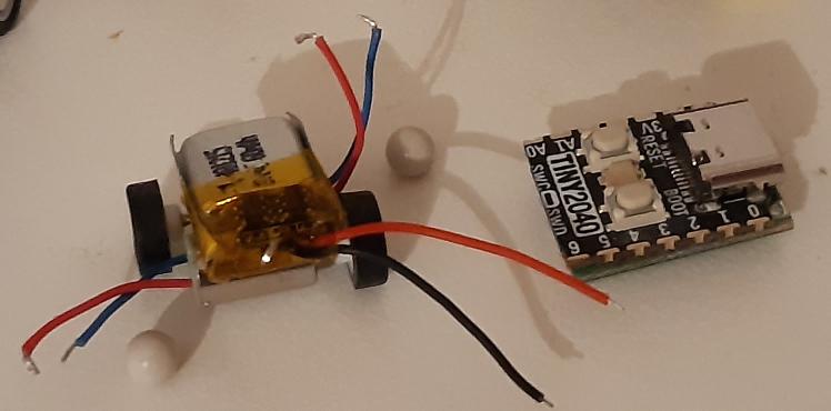

I did buy several small lipos, and the 401215 60mAh lipo took the cake -- it is only 14.6×10.85×3.95mm:
https://forums.raspberrypi.com/viewtopic.php?t=324698&p=1947318#p1946998
With that dimensions the lipo is superglued directly onto the 6mm diameter motors, between the 8mm diameter 3mm wide wheels — plan is now for 19.7×14.8×18.9mm w×l×h RP2040 robot (right: dremeled Tinier2040 sits on top of dremeled as well Pololu DRV8833 motor contoller):
