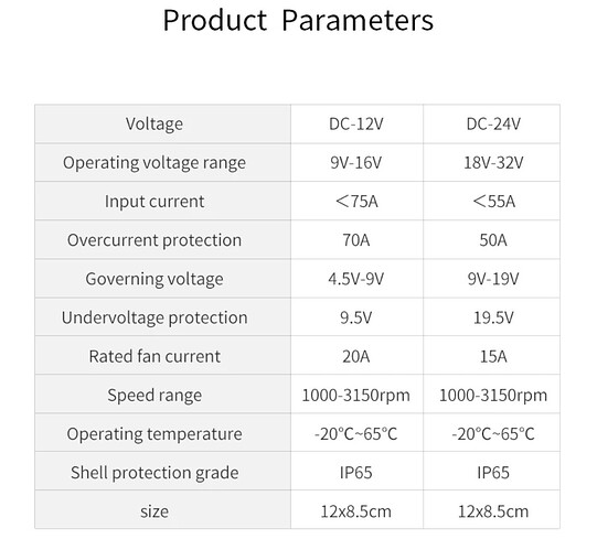

I need to power up an aircon compressor which has a motor of 600w powered by 2V 3 phase AC. The controller supplied with the motor/compressor kit has failed, one phase missing and it occurs to me that I could achieve a lot by controlling the unit with an Arduino instead of a proprietary box with almost no smart ability. I have little or no experience with power electronics and at 66 yrs old, reluctant to learn this, my background is 40 plus years of PLC design, and I have never seen such a peculiar power spec for a motor, any ideas welcome!!

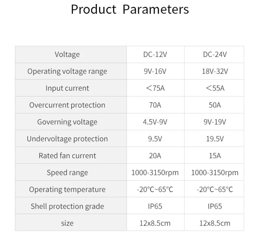

Lets look at it this way, the spec in the system declares it is 600w when run on 12vdc and 800w when run on 24vdc supply. I track and record battery voltage and current, and i know the system draws 51A when running, and the supplied controller is missing one phase output, i have measured 2v across the other 2 phases. Now this is very hard to believe as the 6mm motor cable would be carrying 300A and it ought to get rather warm, and i should have noticed this. However it is more believable that the system uses a 2v pulse to test the motor, perhaps the normal motor supply, is going to be 20V, which makes a little more sense, but it does not change my problem, i am still looking for a VFD type device that i can control with an arduino
OK so after a bit more time and digging I have discovered that the controller I would like to emulate with an Arduino, in fact uses 12 Mosfets to switch each phase from one polarity to the next in a sequence that emulates AC. the end result is not 2v AC at all but rather it seems it should be between 4.5v and 9v and I am betting that with a 12V supply the controller will output 4.5VAC, with 24V supply, 9VAC, and that the 2v output I measured is in fact as a consequence of a failure.

600W @ 9V doesn't make sense, for a 3 phase motor that would be near 40 Amps per phase. Post the motor's data plate info and / or datasheet or other info you can find for the motor. Even a picture (with the data plate visible) might help.
Actually it is 9v when running off 24v supply, on 12v supply it is 4.5v and draws 50A
