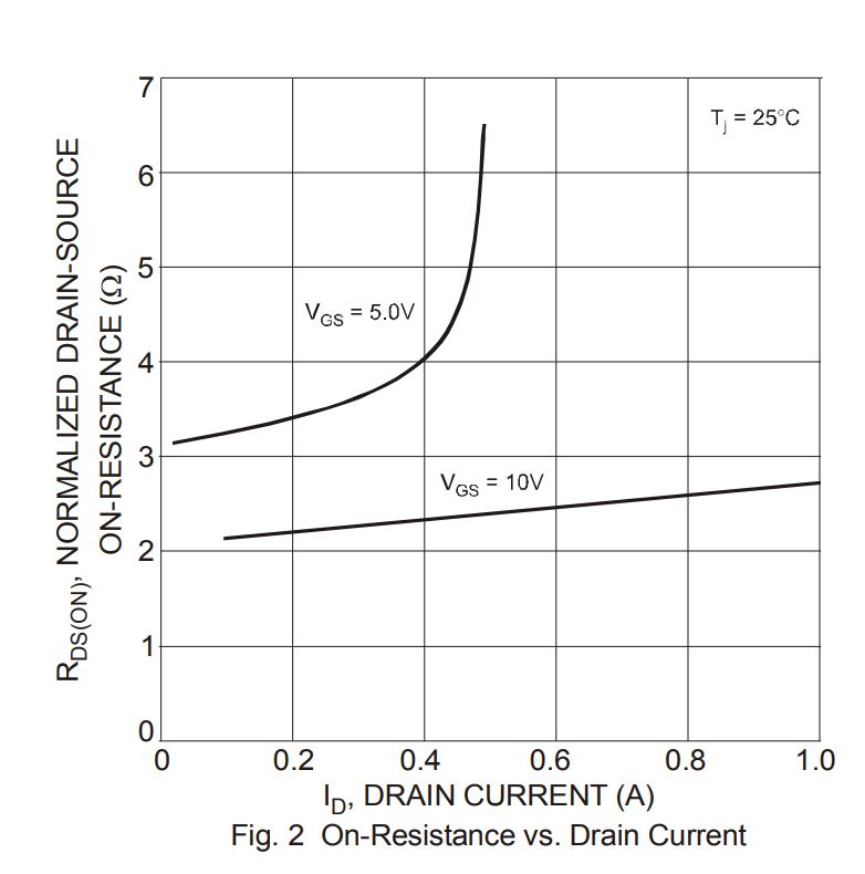

Here's the graph of ON resistance vs current for the MOSFET. Maximum resistance is 7.5 Ohms at Vgs = 5V. Here's the spec sheet.
Perhaps the fact that the buzzer draws very little current has something to do with it?
That MOSFET requires 5V minimum gate voltage to be fully switched on.

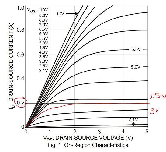

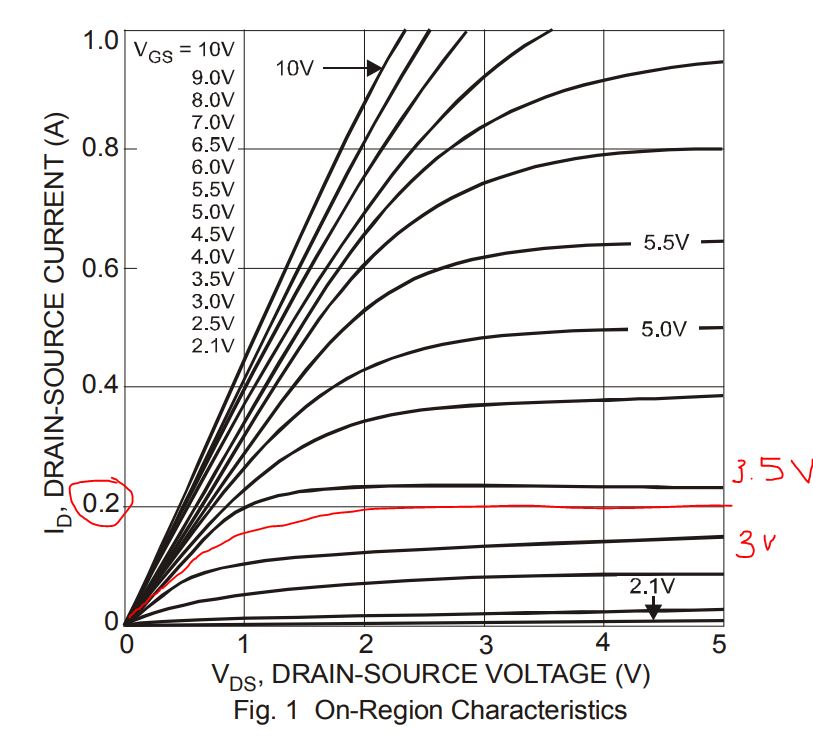

You are NOT paying attention. The threshold voltage is of no interest to us. Please read reply #13 more carefully, and study the data sheet.
In particular, take a look at this graph of the 2N7000 drain-source voltage/current characteristics. Note especially the lines corresponding to different Vgs voltages.

@jremington: If you look at the 2N7002 (the one I am using, which I linked previously), here is the graph, and at 3.3V Ids is about 200mA, and the SSR draws about 5mA. I still don't see an issue here.
I still have no idea why you're saying that the threshold voltage is of no interest to us at all. The lower Vth is, the lower the resistance will be at 3.3V, and the higher the Ids current will be. Simple as that right? For example, this MOSFET has "ultra low drive voltage" (1.2V Vth) and therefore at 3.3V it's fully "ON" (low resistance). Can you please explain what you meant by your bold statement about Vth?
