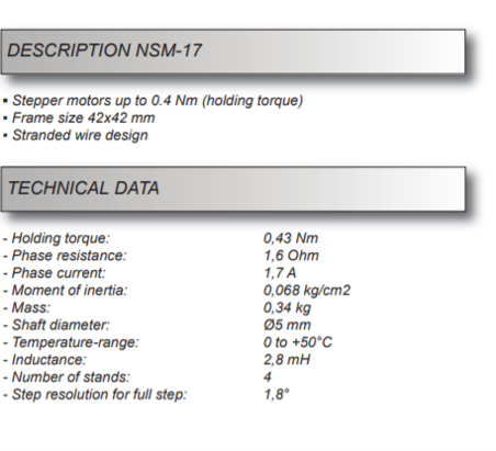

Specsheet from the motor:

Post a link to the motor's datasheet, NEMA 17 only defines the motor's mounting face dimensions, nothing about it's electrical parameters.
That motor's phase resistance is 1.6 Ohms, it's phase current is 1.7 Amps that means 2.72 Volts, right at the DRV8833's minimum voltage rating. DRV8833 is a DC motor driver, you need a STEPPER motor driver like:
Yes, a DC motor driver will not work with modern low-impedance steppers like this, whether or not the
documentation for the driver says it can work with a stepper - that's only for high-impedance steppers
and its very low performance in that mode.
[ that Edwin robotics page is lying to you about using any bipolar/unipolar tepper - very poor
quality information there, but this is not uncommon I'm afraid. Driving a unipolar motor is
completely different for starters, and only something like a 20--50 ohm stepper has a hope
of working (slowly) with a dc-motor chip ]
For low-impedance small steppers usually the DRV8825 or A4988 will be enough - for 2A or more there
are larger drivers, but costing quite a bit more. 1.7A is on the edge, a DRV8825 with heatsink (and hopefully
some air-flow) ought to work for this. DRV8833 - save it for DC motors.

the voltage rating on this driver starts at 6.5V. Won't this be a problem with the 2.7 V from the stepper?
Steppers are current driven, not voltage driven. The supply can be 36V if you want, current
drive delivers the right current whatever the voltage.
Higher supply voltages allow faster top speeds, as this overcomes the inductance of the motor
more (inductance is the dominant factor for stepper motor speed).
