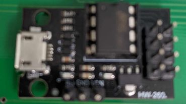

Ds18b20 attiny13
Good day! I'm trying to create a thermostat on attiny13, ds18b20 and TM1637 display. There is a problem with the OneWire library. An error occurs during compilation:

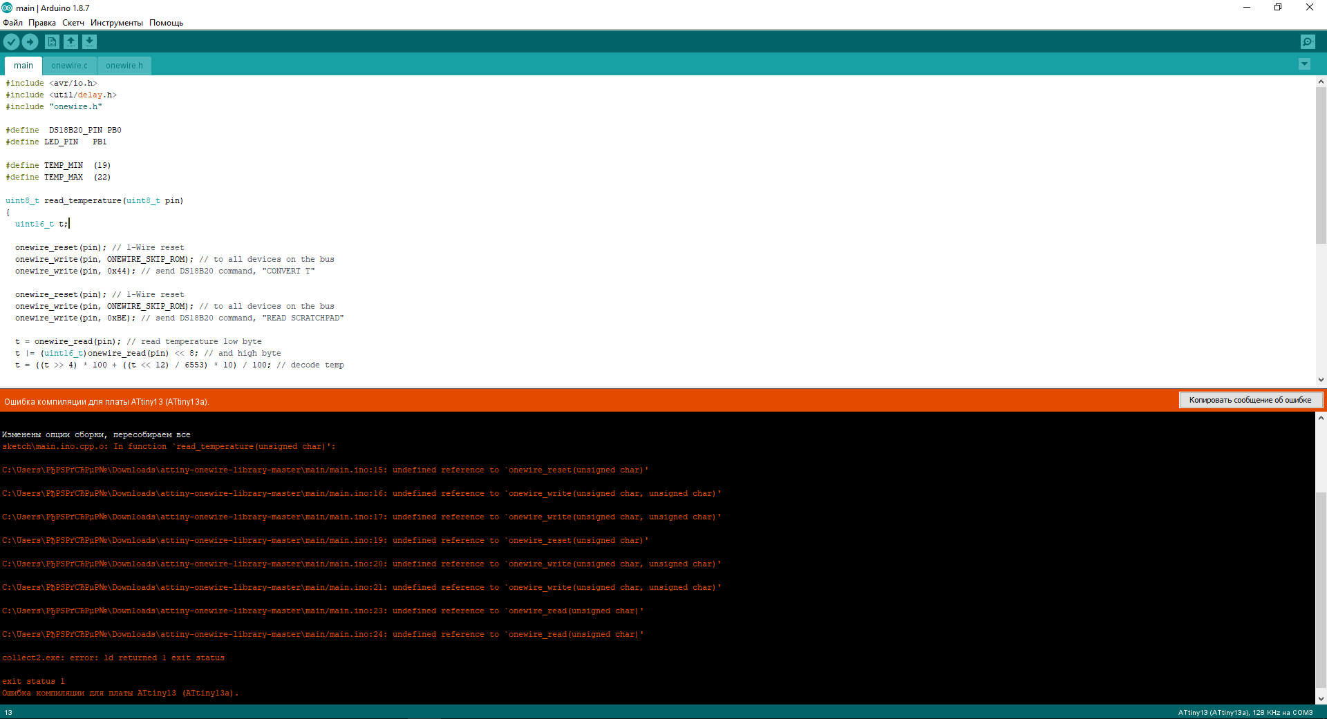

I copied the example, downloaded the necessary libraries, tried to compile the code, but it gave an error. What did I do wrong?
You can try this library instead and see if it solves this problem:
Also make sure that you have installed the Attiny core files and following others steps meticulously:
I can't see anything on your pictures. Did you read a forum rules?
Please do not use a screenshots!
Insert your code and error messages AS TEXT in the forum using code tags.

ERROR:
`sketch\main.ino.cpp.o: In function `read_temperature(unsigned char)':
C:\Users\Андрей\Downloads\attiny-onewire-library-master\main/main.ino:15: undefined reference to `onewire_reset(unsigned char)'
C:\Users\Андрей\Downloads\attiny-onewire-library-master\main/main.ino:16: undefined reference to `onewire_write(unsigned char, unsigned char)'
C:\Users\Андрей\Downloads\attiny-onewire-library-master\main/main.ino:17: undefined reference to `onewire_write(unsigned char, unsigned char)'
C:\Users\Андрей\Downloads\attiny-onewire-library-master\main/main.ino:19: undefined reference to `onewire_reset(unsigned char)'
C:\Users\Андрей\Downloads\attiny-onewire-library-master\main/main.ino:20: undefined reference to `onewire_write(unsigned char, unsigned char)'
C:\Users\Андрей\Downloads\attiny-onewire-library-master\main/main.ino:21: undefined reference to `onewire_write(unsigned char, unsigned char)'
C:\Users\Андрей\Downloads\attiny-onewire-library-master\main/main.ino:23: undefined reference to `onewire_read(unsigned char)'
C:\Users\Андрей\Downloads\attiny-onewire-library-master\main/main.ino:24: undefined reference to `onewire_read(unsigned char)'
collect2.exe: error: ld returned 1 exit status
exit status 1
Ошибка компиляции для платы ATtiny13 (ATtiny13a).`
These threads talks about the same problem. You can check the answers:
Did you installed the library?
Why it residues in Downloads folder?
Also - using non-latin chars in Windows user name could be a problem. Try to install the IDE to the user with latin-only name

You can go with Digispark ATtiny85 Dev Board (6 KB user Flash).
DigisparkAttiny85Board
Figure-1:
Aatiny85 Dev Board
Figure-2: Alternative of Fig-1
