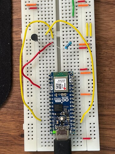

DS18B20 not found, Arduino ESP32 NANO
Hi
I can't find my DS18B20, tried three different sensors (one with 1m cable). Have tried 4.7k, 10k and no resistor. Tried different pins for data. Tried different example sketches, from OneWire and Dallas. The output is always that no addresses are found.
Any help appreciated!

Please, edit your Title to "DS18B29 not found, Arduino ESP32 NANO". the Title should match with yoour picture of the post so that readers are not confused. ESP32 refers to the following board (Fig-1).
Figure-1
I just learned that OneWire.h uses the ESP32 pin numbering and therefore it works if I put pin 21 instead of 10 in the example code above.
OneWire  ds(21);
Reference: Nano ESP32 Selecting Pin Configuration | Arduino Documentation
You have just corrected the title and the the setup has statrted working?
Tell us, what have you done. Post the latest working sketch.
It is a Forum; we need to discuss the problem in order to learn more on the architecture ad programming of ESP32 NANO.
I also added a solution (post #3), is that enough?
NANO ESP32 is a "Arduino NANO/Classic NANO" form factor with the classic NANO pinout. So, decision of decalring OneWire ds(10) is logically correct; but, pracatically it does not work unless the DPin# is chnaged to the original ESP32's GPIO number which is 21.
