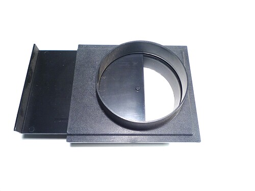

Hi. I am looking to create a project for my workshop that automates dust collection from my wood working tools. I have a system that uses 4 inch tubing and blast gates to run multiple tools. Currently I use 5 gates. I want to use current sensing on the cords of my main tools to open the needed gate, close all other gates, and turn on the dust collector itself.
There is a product that does thus made by ivaccum. They cost $140 per gate plus another part to remote turn on the collector. I can't afford to spend 800 on this and I feel arduino can really lower this cost.
I read and watched a utube video by "I like to make stuff" where he used a key pad to control which gate opens and a small 90 degree servo motor to open the gates. He was using 2.5 inch gates instead of the 4 inch gates I will use. Does anyone know if a servo is powerful enough to move that much? I know they can be expanded to move 4 inches but I do not know about power.
My thought was a small stepper motor with gear drive and a linear gear attached to the gate. These are cheap enough and wouldn't be to hard to program how many steps to move the motor to open and close.

The gates I already have are not butterfly. They are linear.
And no I don’t want to modify my tools.

Exactly. They are standard wood working blast gates. I don't know how to attach a photo but a Google search will show you exactly what I'm talking about. They are very common in serious woodworking shops to control harmful microscopic wood dust.
I get what you are describing. Something like a baffle used in hvac systems to turn off a pope duct. That would work more or less but what I have is an off the shelf common gate.|500x375
Mine are plastic instead of aluminum but same concept. The gate slides in side to side to open and shut
OK manually operated
Steppers or servos i would suggest are overkill for that.
The manual L shaped operating handle. Stick or weld a nut to it. Use a threaded rod , available from builders merchants in 1 M lengths to screw the valve open or shut and attach it to a cheap geared motor.
End stop sensors for closed and open positions will be required. either microswitches or opto sensors i would suggest.
The motor can be controlled either by relays or H bridge.
Its a largely mechanical problem the electronics/arduino can handle this easily.

got a link to a linear valve ? when I was in HVAC they were expensive and very hard to find.
unless you are taking about a blast gate. much more common for exhaust. you have a lot of ways to make this work without using any sort of microprocessor. a simple relay that becomes energized when your motor gets powered and that powers your gate motor and also the exhaust motor.
a simple DC motor, all-thread and a tube with a nut and you can spin the motor to open the gate, till it hits a stop. the relay changes direction and when the gate is full open, or full closed. there is no power used.
