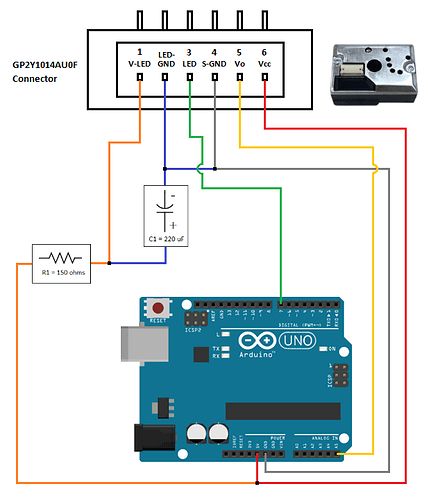

Can anyone please send the real arrangement of wires on the breadboard of the Dust SENSOR with ARDUINO UNO R3 with the help of this diagram given.

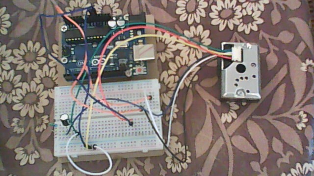

I did it like this...

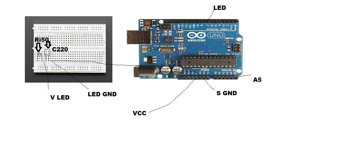

ARDUINO UNO R3, please. Also the same as the schematic given by me.
please check with what i have done.
PLEASE HELP!!!

Looks good so far. What happened when you tried it? Instead of saying "didn't work!" try to explain what you expected to happen and what actually happened. Show your code, in code tags.

From your photo it's hard to see but I think you're not connecting the wires to anything like that. They need to be in the same column on the breadboard, not the same row. Only the +ve and -ve rails at the top and bottom connect across, the other holes connect up and down with a break in the centre.
It won't stop it working, but the pulse timing in the code you linked to is wrong too.

Which side is + on the capacitor?

Is that a serious question? As a clue, it’s not the side connected to ground...

i tried from the pic but when i connect the last red wire (voo) the UNO gets off please help
How are you powering the Arduino+sensor?
Do you know, from the sensor datasheet, how much power it requires?
There is no Voo on your original diagram. Please check your connections.
If the Arduino powers off then you’ve possibly connected 5v to ground somewhere.
