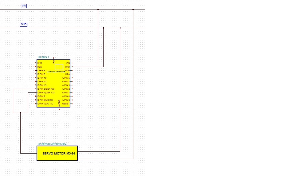

Hi guys, I'm using a servo Dynamixel MX-64T and I'm having a problem in feedback position command or reading position and temperature.
I'm using the library Dynamixel_Serial - V2.0 at Google Code Archive - Long-term storage for Google Code Project Hosting.
I use Arduino 1.0.4 environment with Pololu Orangutan B-328 robot controller with connection to TX and RX.I have connected RX and TX together because MX-64T uses half duplex serial.
The VIN is 12 VDC regulated. Attached picture is the wiring. Using the example code that comes with the library :

Still not much to go on. I now see the servo in question but there is absolutely no data on the page that tells me how it communicates.
That diagram is rubbish. It just shows two wires on the arduino being connected together and one wire going on into the servo. Is that really how you have wired it? If so why.
You have not posted any code that you are trying to use with that library.

That diagram still shows the transmit and recieve pins from the arduino wired together and then on to the controller. If it is wired like this you will never recieve anything back from the controller.
Hi,thanks,can i ask how to wire it since the wiring of mine is wrong.
Thanks
I would have thought that the RX arduino pin has to go to the TX on the servo driver and the TX on the arduino has to go to the RX ont the servo driver. The two wires should not be joined together.

Thanks for the info however what you are mentioning is the traditional sense of seperate Tx and Rx. That is the full duplex UART. However im using half duplex UART. Therefore I have to share the same line for Tx and Rx.It is listed inside the dynamixel MX64 doc which is this link http://www.crustcrawler.com/motors/RX64/docs/DYNAMIXEL%20MX64T.pdf under the protocol section.Do review it.Thanks again Mike.
The servo might have a half duplex connection but your arduino does not. Therefore you have to make one you can not just connect the TX and RX together.
You can make one with a data select multiplexer and an arduino pin that selects if it is in the transmit mode or the recieve mode.

Yes read page 12 that says you need to build a special half duplex controller. You can't just connect it up to an arduino directly. This will be something like I outlined in my last post.
From your linked manual:
Protocol RS485 Asynchronous Serial Communication (8bit,1stop, No Parity)
Link (Physical) RS485 Multi Drop Bus
So you are going to need a RS485 transceiver converter module to convert the arduino serial TTL full-duplex to a RS-485 half duplex wire pair and use an additional arduino digital output pin to control the transmit enable pin on the RS-485 module in your sketch before and after every time you send a message to a servo. Not hard.

You don't need the differential pair. In the first post he says he already has it working talking to the servo it is just he can't get anything back from it. This is due to him wiring the arduino's TX and RX together. He just needs a data select for the arduino end.
Thanks to everyone! You all have been most helpful. Perhaps I failed to point out is the MX-64 servos comes in two versions - MX-64R and MX-64T. The R version uses RS-485, while the T version uses TTL. What I have been using is the T version, hence it can talk directly to it using the Baby O without any RS-485 conversion. Thought I point this out because the links so far could be misleading (it talks a lot of TTL <-> RS-485 conversion).
Since the T version uses half duplex, I initially wired the Tx and Rx together on the Baby O side. I got the servo moving just fine, as mentioned in my first post. The problem comes when I try to get a feedback from the servo. The data I always get is 3968 (using the serial monitor). Checking the Dynamixel_Serial 0 V2.0 .cpp library file, I confirmed it is an error packet. I messed around with it by changing the the return error packet line to just return (2). As expected, the data I get is integer 2.
As Mike suggested, I have wired up a tri-state buffer SN74LS241N like in the image attachment. More info is at
