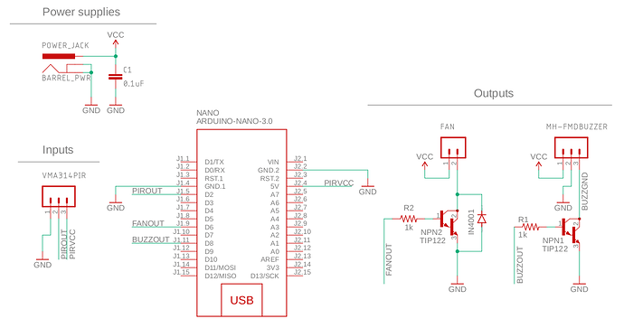

I'm a beginner and today I tried taking a Fritzing breadboard across to a Eagle PCB (attached). I went through a few iterations and this is where I am now. I was wondering if some experienced users of Eagle could give me some pointers on how to improve this?
e.g.
How much should the schematic be split up? This latest iteration involved splitting up the schematic into multiple pieces, as it seemed to be the Eagle way of doing things. Have I overdone it? Underdone it? Is there are a rule of thumb for this?
With orientation. is there a convention for whether names / values / labels should be at the end of nets, running alongside them, horizontal, vertical, etc.?
Anything else you would do differently?
Thanks
Place your loads in the collector path of the TIP122s.

I put schematics like that together all the time. Way easier to follow vs lines running all over the place.
Be sure to use the error checking to make sure nets have the same names, I've hosed myself a couple of times with a typo that left a signal unconnected. Use error checking on both the schematic and then on the board layout.
And sourcing current like that from a TIP122 will not yield good results. That's an NPN setup, it wants to sink current to GND. You want a PNP setup if you are going to source current.

To clarify the issues with the TIP122s. I bought these earlier this week after my BC337 NPNs couldn't power the fan or buzzer. They seem to be working ok but if I understand the comments the correct way to use the TIP122 is for the load (e.g. fan, buzzer) to be in the same path as the collector of the TIP122, and for the emitter to connect to ground? If so, I'll have to go and think about this as currently the GND for each load is connected to GND.
I've made changes to the TIP122's to incorporate the suggestions earlier. I'll have to do some more reading to understand why it's better this way.
Also just generally tidied up and implemented some of the ideas from the 30 min or so of the youtube video posted above. Feels like an improvement from yesterday?
