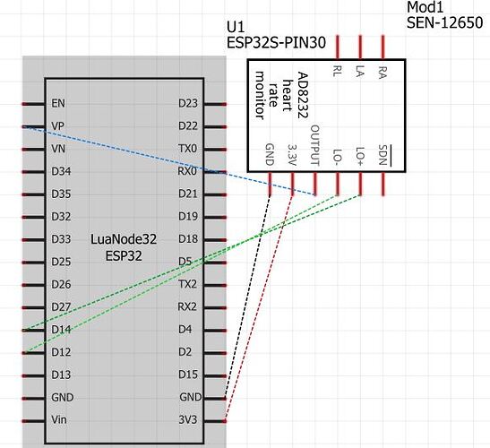

I am trying to generate proper ECG graphs using ESP32 with 30 pins and AD8232 heart rate monitor. After several attempts, I am failing to get proper ECG graphs. Can't figure out what is going wrong here. Are the ecg electrodes placed wrong or what is happening? Can anyone kindly help? I have a deadline to meet. Attaching my graph screenshot.
I don't manage to magnify the X scale. Never mind. The signal doesn't look lika an electrocardiogram at all. It looks like a sina curve likely picked up from mains.
I suggest You post the schematics and also try google on "Arduino + ECG". There are several projects like Yours.

Could you please post your code in code tags, and a diagram of your actual hook-up of the components to the ESP
An ECG is a graphical representation of the electrical activity of the heart and requires at least 2 points on the body. A standard ECG uses 12 leads. Normally the signal is filtered as electrical activity in other muscles can cause artefact. Your trace does not look like the subject is still alive
Thank you so much for your reply. Here is my circuit diagram. I am new to this. So any suggestions would be really helpful.

Edit :pencil2: code into code tags <|>. Give description of how you obtained trace. Your circuit diagram is incomplete and would not create any output
I am connecting the ESP32 with micro-usb port with the laptop for powering. Not much sure what you mean. :roll_eyes:
A human presumably is in the circuit
Yes I am using the 3 lead ecg electrodes on me. How do I possibly show that in the diagram?
Fritzing are poor but I would add a lead with a label on a schematic stating electrode for right wrist etc
Okay. I would do that. Thank you for your feedback. Apart from that, are the connections okay?

There are countless ESP32 boards - do you know which one you have? (hint - give a link)
Generally the pin marked VP is analog input ADC1 ch 0 on GPIO36
There is a good tutorial here on reading an analog voltage with the ESP32
I'd suggest you connect a pot as shown and try it. You could use GPIO36 instead of GPIO34 as the tutorial uses.
