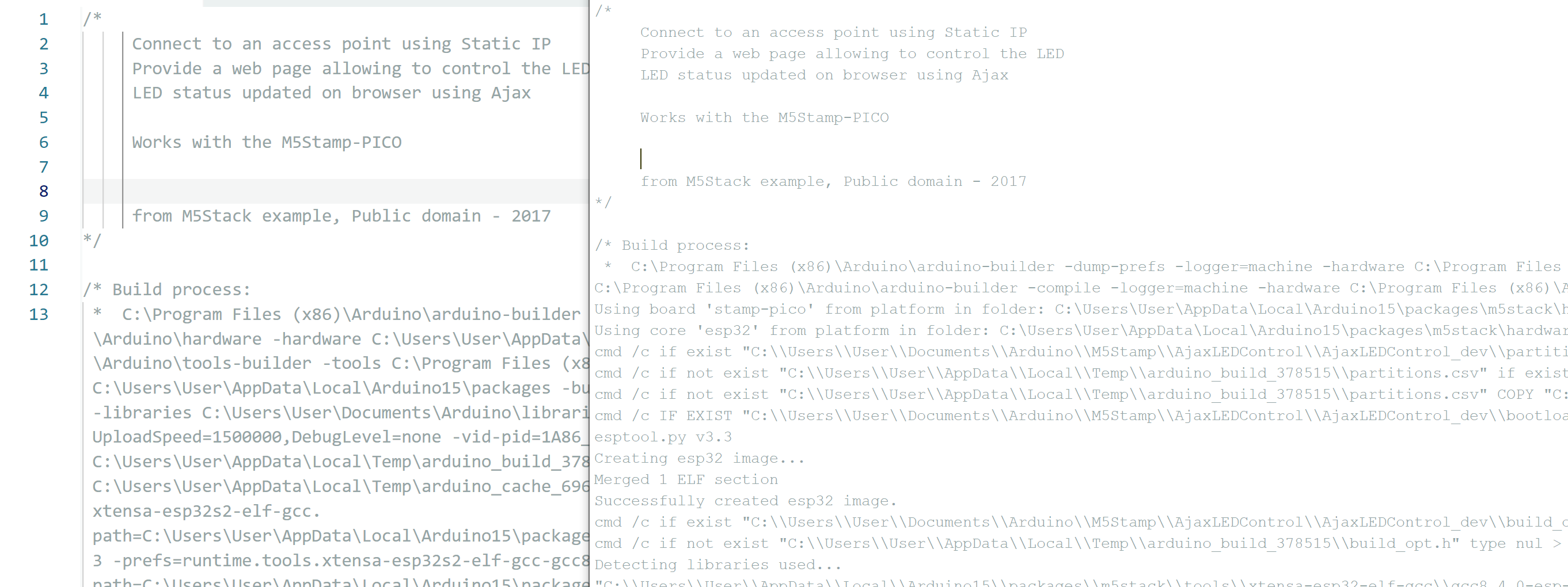

Here is a screenshot of the editor to the left (everything in the editor window is a comment in this screenshot) and my text editor to the right.
I cannot imagine anyone would think they are equally legible, but regardless it is my opinion that the left is considerably worse in legibility. It is very tiring to look at after a while, and no, while I am older, I do not have visual impairments. Thank you for the suggestion. If I did, I would have indicated so. But I may work hours a day on a project and ergonomics are important to me. While it can be, at times, a hobby, it is also my job.
I understand IDE 2.x has a more convenient way to deal with this, indicating that a need was identified. I actually have taken advantage of it as you can see below a comparison between 2.0.1 (left) and 1.8.16 (right). I was able to change the font size and colors of 2.0.1 so it is much more legible.
Unfortunately the IDE 2.x does not install on my work machine, apparently due to the corporate firewall (and looking at the concurring messages I got in response to my posting on this forum about that other problem, I am not alone with 2.x problems behind a firewall, while the older 1.8.16 runs fine). Therefore I have standardized on the older 1.8.16 which works in both places.
I know the IDE is reading (and saving) the theme.txt file because my text editor lets me know the file has been updated in the background, but apparently the settings I added are not used in any way.
So in summary I made no progress :frowning:
