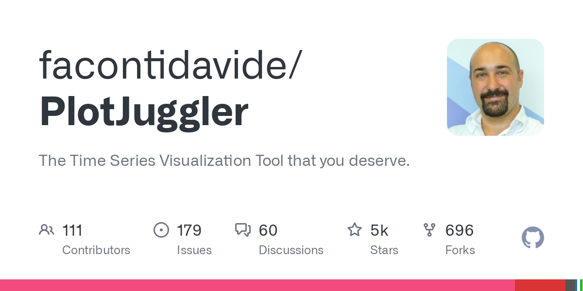

I just found
but have not yet see if it lives up to its claims.
