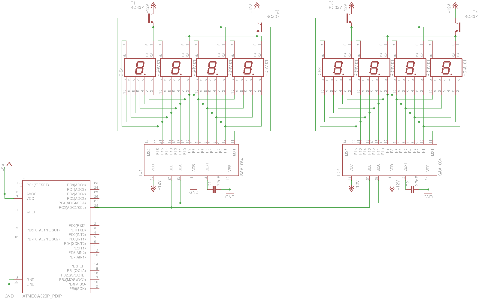

Hi, an alternative idea to look into would be to use 2 x SAA1064 driver ics. These would keep your component count down (4 transistors and a couple of resistors & caps) and do the multiplexing for you. They use the i2c interface. I have used them in the past to drive 1.2" blue 7-seg displays with 9V supply, but they are good for up to 15V.
Paul
streetto:
Can I ask why should be necessary that many transistors with the first approach? And shouldn’t a 9-10V supply be enough to work OK?
Well, the buffers have to switch a higher voltage, and the only configuration that can do that is a common-emitter (common-source) one, which inverts the logic. If you invert one "side" of the matrix connections, you must invert the other side also which turns out to be very convenient if you are using a common-anode display, as the MAX7219 is somewhat easier to program for common-cathode displays, and the logic inversion makes the common-anode display, match.
However, the MAX7219 still cannot directly switch the "high side" buffers, so it requires a third set of buffers, in common-base configuration; total: 24 transistors.
Unfortunately your datasheet does not (unless it is hidden somewhere) specify the voltage drop of the four-LED segments. OK, so they are red, so it is probably something like 7 to 8V and so 10V may suffice.
The thing is that 10V is not a standard supply voltage, but 12V is. Or do you propose to use batteries? If so, you would still be using either a 12V "gel-cell" or an 11V Li-Po battery.
I've drawn a schematic for you. Hopefully it will show how much simpler I think using 2 x SAA1064 will be.
