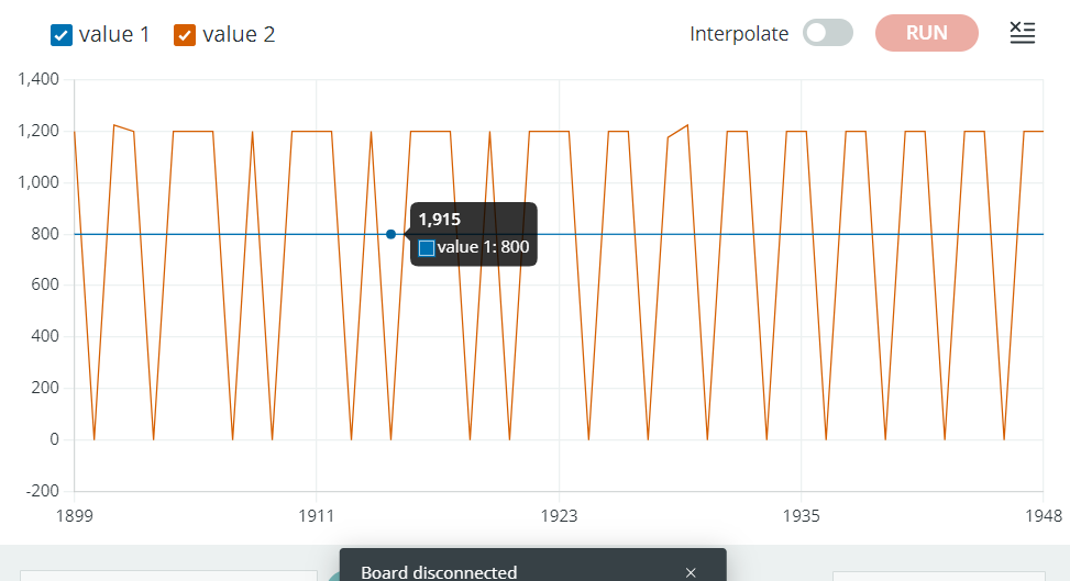

Hello. I am having issues after following this video on PID motor control.
Video: https://youtu.be/pOFakaTQDXM?si=Vvpwa2LANOxi_RbT
My motor has 70 PPR and I followed the schematic attached.
When I keep the channel 1 and channel 2 encoder wires attached to the pins in the schematic in that order, the motor moves at 1000 RPM and does not change even after changing Kp. The serial monitor also says the motor is moving at 0 RPM and the serial plotter shows the RPM at zero.
When I switch the order and connect channel 1 to pin 3 and channel 2 to pin 2, the motor switches between like 2000 RPM and zero. Despite changing the Kp values the plot barely changes and its stuck fluctuating between these values.
Here is the code I used:

No matter how much I change the Kp, Ki and Kd values. The RPM just fluctuates from 0 to 1200 RPM.
