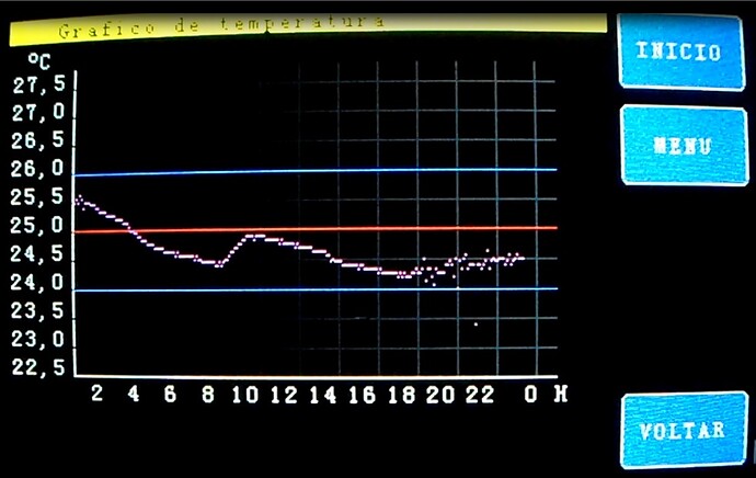

So you could get something like this:
The side button should be removed since your TFT is smaller.
The TFT in the picture is 400 x 240.
I'm using this library that also is compatible with ILI9341.
