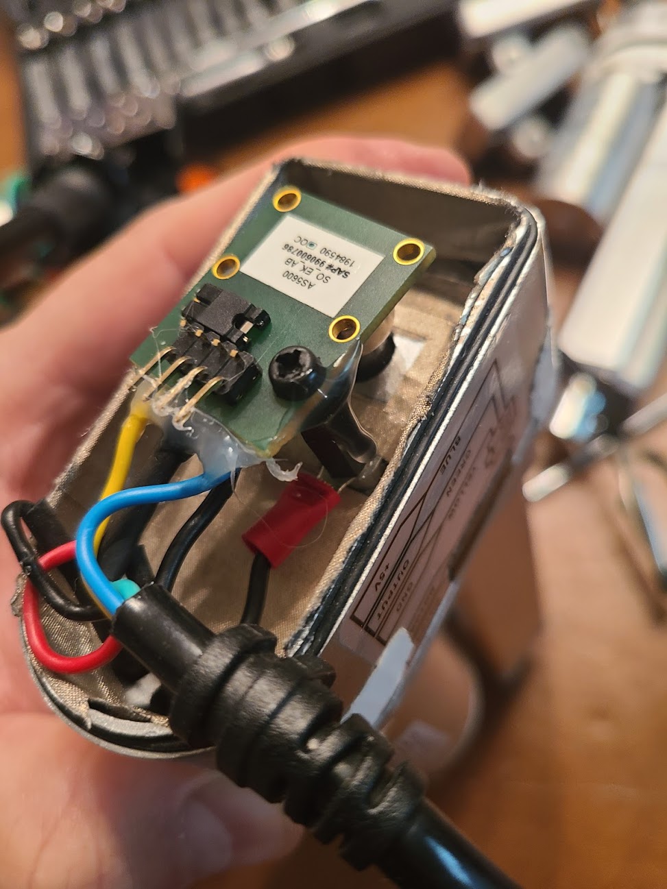

The actuators came supplied with the proprietary wiring harness.
I don't have many options here unless someone knows where I can source custom IP66 wiring harnesses for it.
As I mentioned earlier, I've managed to fix the stability by using a 2k resistor on the signal line, but I lost accuracy. I'm hoping someone can explain how I can reduce the accuracy loss. If I can also source a better wiring harness, then win-win!

I'm using the VIn, Gnd, and Out pins on the AS5600 encoder. I tried using the I2C connections but the noise was too much so I switched to the analog out.
I've attached a pic of the 5 wire harness.
So basically just an IP66 waterproof box with a small connector pcb ?
Splitting the cables should be quite easy by just adding the gland type cable entries.
Or true IP 66 connectors with a through socket, preferable two different ones to prevent accidental connection to the wrong group of wire.
Look up IP66 glands and IP66 connectors.
Going back to the loss of accuracy the resistir might be too high for what they use as switches inside so maybe a lower value.
OR there is insufficient voltage getting there in the first place which you can check with a multimeter.
