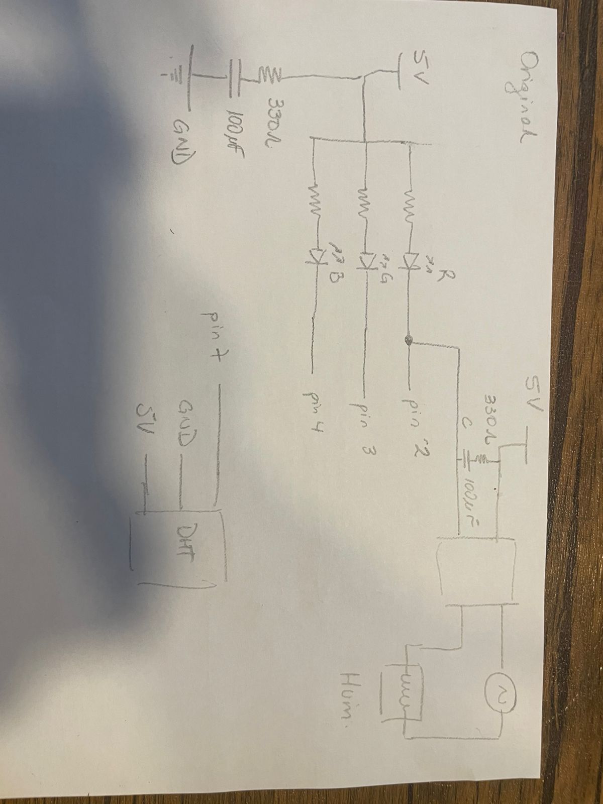

I am working on a control circuit for a humidifer in a shiitake mushroom growing room. That equipment consists of an AC motor that spins a disk spraying mist over the room, rated at 300W working under 220Vac. The arduino opens or closes the circuit via a solid state relay SSR25DA, based on the humdity read by the DHT sensor.
I have designed the four following stages:
Stage 1: Humidity below 75%. SSR is on. Red led on.
Stage 2: Uptrend from 75% to 85%, SSR on. Red led on, green led flashing.
Stage 3: 85% or more reached. Only blue light on. Relay is off.
Stage 4: Downtrend from 85 to 75%. Only green led steady.
Error code: upon NaN read by sensor: flash green.
The circuit failed when using the humidifier as a load, with error code.
This circuit works fine with loads light a light bulb. I found that turning on the egg beater close to the circuit leads to the same error. This egg beater runs at 300W too. I added a snubber at the 5V terminals of the SSR. With this, i could run the egg beater to speed 4 (out of 5) with no failure. failing at 5. (when connected as load, at a distance of 5m of the arduino). This makes me think that maybe the mains cables themselves cause EMI on the arduino (distance = 0.5m from the SSR to the soldered breadboard. Not sure.
I have provided code and schematic. I am thinking of implementing a second circuit but wanted to ask for suggestions first.

New circ
Original circ
You show a lot of ground symbols, but are all those leading back to a mains ground for the building wiring? Are all the motorized devices grounded to that same ground?
Thank you for your reply. All ground markings correspond to the GND pin on the arduino, itself connected to USB power.
I am thinking EMI could be affecting the sensor reading, thus leading to the NaN error code. Has anybody had this issue? (I'm thinking of adding coax to the DHT's wire line as a possible solution). I will also test adding distance between the sensor wires to the mains lines.
So nothing is grounded to the AC power ground, including the motors.
Oddly enough, the humidifier (basically a 300w ac motor ) does not have a ground in its plug. I will have to check whether it can be grounded and add that for safety.
Still, the arduino isn't grounded to the AC power ground either because it is powered by a 5V dc adapter via USB.

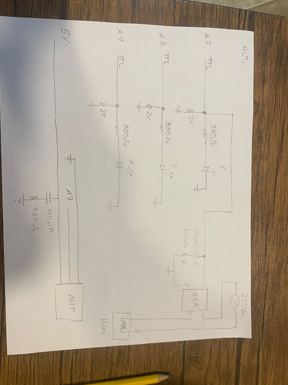

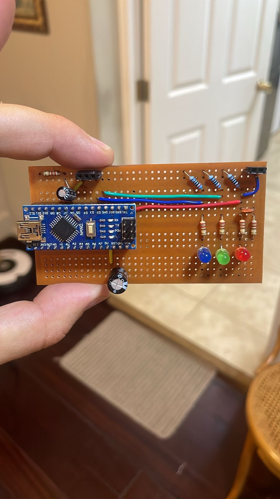

Alright. Today I got some progress. I remade the circuit according to the second schematic. But still had the issue, now at higher speeds for the eggbeater though.
The filters worked, but not well enough. My next thought was coax. But I don't have coax. So I tried grounded aluminum foil. Finally. It worked. Video is shown below:

I don't think we are on the same page here as to what a snubber is. This is something that is applied to the output of the SSR not the input.
See the RC snubber in this link:-
and
It is designed to lower the rate of change in voltage with respect to time.

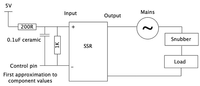

I think what you have here, on the input circuit is not a snubber but an input filter. The time constant for this is way too high and the circuit is not correct.
This is my attempt to show what you need.
Can other members please give this a sanity check @Paul_KD7HB @gilshultz By the way, I am not a fan of Nuts & Bolts as they seem to be rather flaky on other information they supply.
The input filter on the SSR is designed to reduce the impedance of the SSR to reduce false triggering of the input of the SSR caused by having no snubber circuit on the SSR's output
Note that the snubber components must be rated for at least the peak mains voltage. You can buy snubbers packaged together as a single component from ebay.
EDIT, Sorry my bad see post #17.
The snubber is an RC combination, resistor and capacitor in series that is in parallel with the load, not in series with the load.
The snubber will definitely go in parallel and not in series with the load. And yes - I guess I mistakenly called the other filters 'snubbers'.
