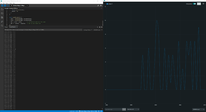

I'm trying to get a code working for reading the feedback of a encoder and displaying it on the serial graph as RPM, I got it to work but it reads positive for both directions. Could someone help me with getting CCW to display as negative number on the graph?
Also just wanted to see if there any way to speed up the feedback plotting on the graph and a overall thought on improvement i could make.

Picture to see feedback and graph plotting. This was quick turns of the knob both directions a few times

Why aren't both set to INPUT_PULLUP?
i changed them but to INPUT_PULLUP but still wont read negative
So, that evaluates to read the 24th bit of port D. Does that make sense?
Why not just use digitalRead() there? Or use the digitalReadFast() function of the digitalWriteFast library. if you need speed.
Since the variable named pulse is multi-byte you should guard against interrupts while you read it. You do not want an interrupt to happen in the middle of reading the variable. It could be corrupted.
